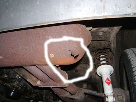

With my car on a lift for the first time, I naturally noticed a few things...
Are these anything to be immediately concerned about or just "when I get to it"?
hole in exhaust
cracked almost all the way through

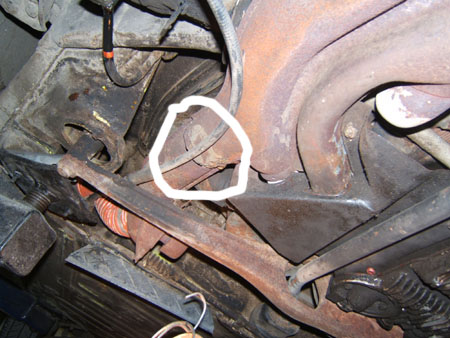

That line you have circled in the 2nd picture is a seam where the heater "horn" bolts to the heat exchanger. One bolt on the bottom, one on the top. As for picture #1, the shock looks like junk. Oh, and there's a hole in the muffler. The Cap'n

If ya gots a welder you can patch it so it lasts for another month of so...time for a set of Stainless Steel heat exchangers and a new muffler or Bursch.
and a set of quality shocks!

Can I tape up the seam or something?

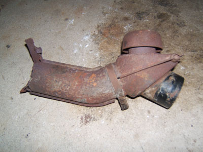

When I gave up and paid someone to replace my rear brake lines, he removed the piece pictured below and didn't reinstall it cuz "I didn't need it anyway"... What is it?

The pic is of a heat flappers which controls the heat either going into the cabin or being dumped to the outside air.
I would seriously look into good SS heat exchangers and a Bursch. They aren't too loud or for quiet you can get a Dansk banana muffler.

I am in a similar situation = leaky HEs and cabin fumes. I have solved this probelm by removing BOTH of the pieces like you showed with the heater flaps extending into the cabin. This entry point for the heater air is how the majority of fumes get in the cabin. HEs without a good seal (read most 30 yr old steel pipes) will leak exhaust into the "isoalted" hot air tubes which head through the flapper valves and into the cabin. I plugged them both. No heat, but also less CO. (IMG:style_emoticons/default/beerchug.gif)

Okay, wait a sec. Those flappers allow air that is bled into the HE's (head exchangers) to exit i.e. there's always a flow of air through the HE's. This helps keep that part of the system from getting too hot. Air-cooled VW's use the exact same system.
When you 'turn on' the heater, air is sucked from the engine bay then pushed through the HE's. You cannot get CO or CO2 or NO or other engine exhaust into the HE's unless it's from the car in front of you. If the HE's are like mine and not fully sealed to the exhaust pipes then you'll simply lose air flow out these leaks and receive less air into the cabin since the HE's will be PRESSURIZED with the air coming from the engine bay (IMG:style_emoticons/default/wink.gif) Any smells you're getting would be coming from stuff burning off within the engine bay. Again, if your HE's are like mine and you have oil leaking from your engine then you can get oil inside your HE's and this will cause a bad smell (as my g/f told me once, "You smell like car."). Also, oil leaking on the exhaust and HE's will burn off and cause smoke/fumes. If such fumes are generated at the front of the HE's, like the area where the lower engine tin ends, or oil leaks on the engine itself that are under the engine tin, then those fumes can get sucked in to a leaky HE where the air enters the HE from the fan housing. It doesn't take much at all to create a bad smell.
On replacing/re-installing those parts, YES, put them back in even if you don't use your HE's! And that's not only my opinion but that also of a certifed VW dealership mechanic of 25+ years (those years of air-cooled VW's, BTW). If you don't want to use your heater, fine, remove the flexible hose that connects to the firewall. Of course, if you run a header (no HE's) then this arguement is moot.

The muffler, other than that one hole, is solid otherwise.
