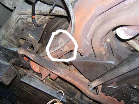

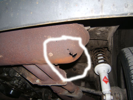

With my car on a lift for the first time, I naturally noticed a few things...
Are these anything to be immediately concerned about or just "when I get to it"?

That line you have circled in the 2nd picture is a seam where the heater "horn" bolts to the heat exchanger. One bolt on the bottom, one on the top. As for picture #1, the shock looks like junk. Oh, and there's a hole in the muffler. The Cap'n

If ya gots a welder you can patch it so it lasts for another month of so...time for a set of Stainless Steel heat exchangers and a new muffler or Bursch.

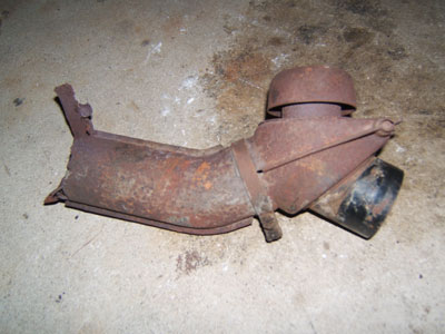

When I gave up and paid someone to replace my rear brake lines, he removed the piece pictured below and didn't reinstall it cuz "I didn't need it anyway"... What is it?

The pic is of a heat flappers which controls the heat either going into the cabin or being dumped to the outside air.

The muffler, other than that one hole, is solid otherwise.
why did you remove that in the first place?
confused24.gif Andy
BigDBass
The local VW mechanic removed the flapper box when replacing my rear brake lines. He said I didn't need it. I was hoping my trust in him would build.
It looked to me like part of pipe on it or to it was rusted through, but I will try to put it back on tomorrow.

After taking a closer look, the flapper box is solid. Not pretty, but passed the screwdriver poking test and did my muffler apart from the hole and a very small part of the surrounding area.
The rusted through piece is the warm air elbow.

Since you have a spot in the muffler that has rusted through, it is probable that the internals of the muffler could be rusted too. If internal baffling breaks away and restricts flow, it could effect the running of an engine. Fully plugged flow, the engine will not start.
