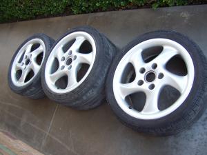

heres what they look like. they resemble wheels sold as "turbo" or "boxster" wheels on ebay. ill have to contact the seller about offset numbers.

I think with those wheels you would need really thick spacers to get them to fit on the car.
right now it does not matter what the offset is, the size of the spacers will be partly dictated by the flare...right now, who cares what the offset is,,,,,you'll need spacers....unless you build a tube frame car and use a radically different suspension...then you can install them with no spacers...
so, yes, the rims can work, and those have been mounted before on a 914...now just save your money....of course now most of the newer 997s are coming out with 19" rims so just wait for someone to ask the same question all over again (IMG:style_emoticons/default/smile.gif)

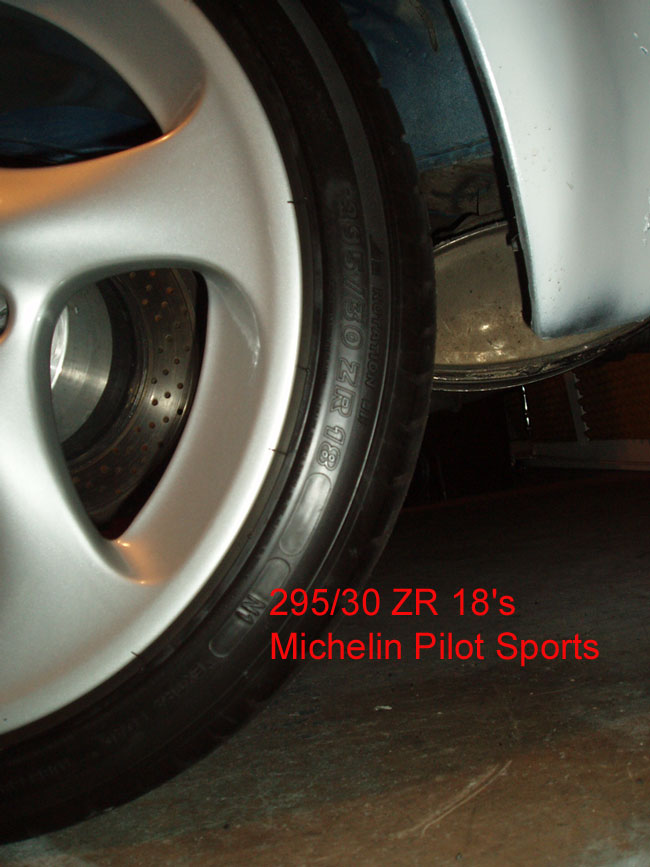

Build it, they will come!
(IMG:http://www.914world.com/bbs2/uploads/post-3533-1150268122.jpg)

oh, and to answer your question.
to the best of my knowledge, no. not in a modern porsche wheel.
spacers are required.

wheel width: 8's and 11's
hubs and rotors: complete 911 front end. rear is spaced 914 caliper with vented 911 rotors with reduced diameter to fit the caliper and maintaining E brake (street car).
flares are sheridan.
see the last pages of my progress thread for more in depth answers to all of your questions HERE

ouch...those rear tires are almost $400 each.......wow.....
