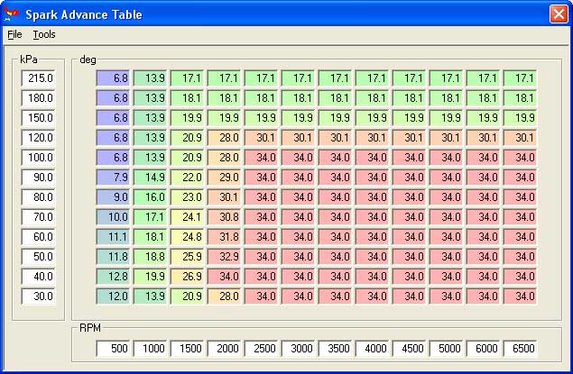

Not getting any response on the shop talk forum....project is a blown Type 1 motor. It's a stroker 92/82 displacing 2180ccm and it has the Hideaway turbo kit from CB Performance with a HEI ignition. We put on a Megasquirt-II instead of the Delco ECU to get more tunability. Now I am looking for some pointers for the ignition table. Here is what I came up with so far. Please give me some feedback.

I've never tuned anything with forced induction but, that seems like a lot of advance. Also with that stroke should you be pulling some advance out to acount for the high speeds at high revs.

I think you have way to much timing dialed in, also way to early.
We time turbo cars (911s) to have 24 deg total advance, sometimes 22
Im not familiar with the megasquirt system, does that table take into account the engines static timing?

As to the values in the table, 46 degrees seems insane to me.
Is this a hot street car, or a drag car, or what?

I'd consider running a lot less timing, like 36 degrees as the max. Keith Duckworth used to be very pleased when any engine could run at peak performance with less than 25 degrees of timing. Engines with pretty crappy combustion chambers often need 10 degrees more than that. Any more, and you're most likely working against yourself. It will probably even run cooler. However, I know nearly nothing about Type Is, and absolutely nothing about turbo Type Is.
Those big jumps, like running 20 degrees at 1000rpm and 27 at 1300, at 90kPa, seem odd to me.

I am trying to read your settings. Change your boost settings to psi instead of KPa. Since I am not used to reading settings the way you have it I am probably going to reference the wrong areas. My maps are different.
First, is the timing synced with the engine. Are you showing total timing or are you supposed to add your base timing to the values in the map.
Next, why is there a weird dip right off idle? Where is WOT on this map? Up top right corner? If that is the case then you are probably about right on the timing. Remember you can run tons of timing at part throttle and cruise.
What do your plugs look like? What do your AFRs look like under cruise and boost. What is your static timing at the Dizzy?

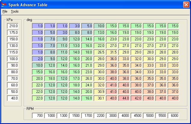

Mike read this and email this guy, I know he'll share his maps and he has "real" MS turbo T1 experience.
http://www.msefi.com/viewtopic.php?t=7960

Mark, this is the table from Minami over on the Megasquirt forum that you've mentioned in your link. He claims he has run up to 17PSI boost. Well, he uses water injection under boost to keep the charge cool.

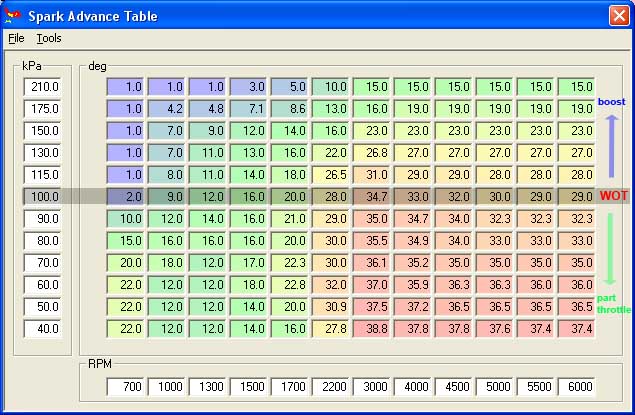

Brett, the timing values are absolut. Megasquirt allows to set the static offset to make all values in the table real. We checked with a timing light and it is pretty close. The dip from 700 RPM to 1000 RPM is something I found in all Bosch Motronic maps. It prevents the engine from stalling by bumping up the advance once the RPM wants to drop below the 1000 mark.
To read this table and convert kPa to PSI think about the 100kPa line as WOT. Everything above the 100kPa line is boosted and as we go down to 40 kPa we have vaccum (closed throttle)
120 kPa = 2.9 PSI boost
150 kPa = 7.3 PSI boost
180 kPa = 11.6 PSI boost
215 kPa = 16.0 PSI boost
The fuel map will get tuned with an LM-1 as feedback. We will set the cruise area lean to make sure we can afford to drive it with 4$ per gallon here. Under boost it will be closer to 11:1 to make sure it does not burn the pistons. Megasquirt has the option to use the wideband O2 sensor signal and shoot for a target AFR depending on RPM and load. Once the map for fuel is dialed in we will put a narrow band O2 sensor in permanently. Hm, maybe I'll ask Mike to apply for a SMOG certificate with his friends at the DMV if he gets the oil leaks under control (IMG:style_emoticons/default/biggrin.gif)
Here is my latest rendition of the ignition map. I smoothed out some of the rougher areas. Remember that Megasquirt interpolates between RPM bins. I guess we just have to take it to the dyno and see how it does and then to the machine shop if it grenades....
What do you guys think,

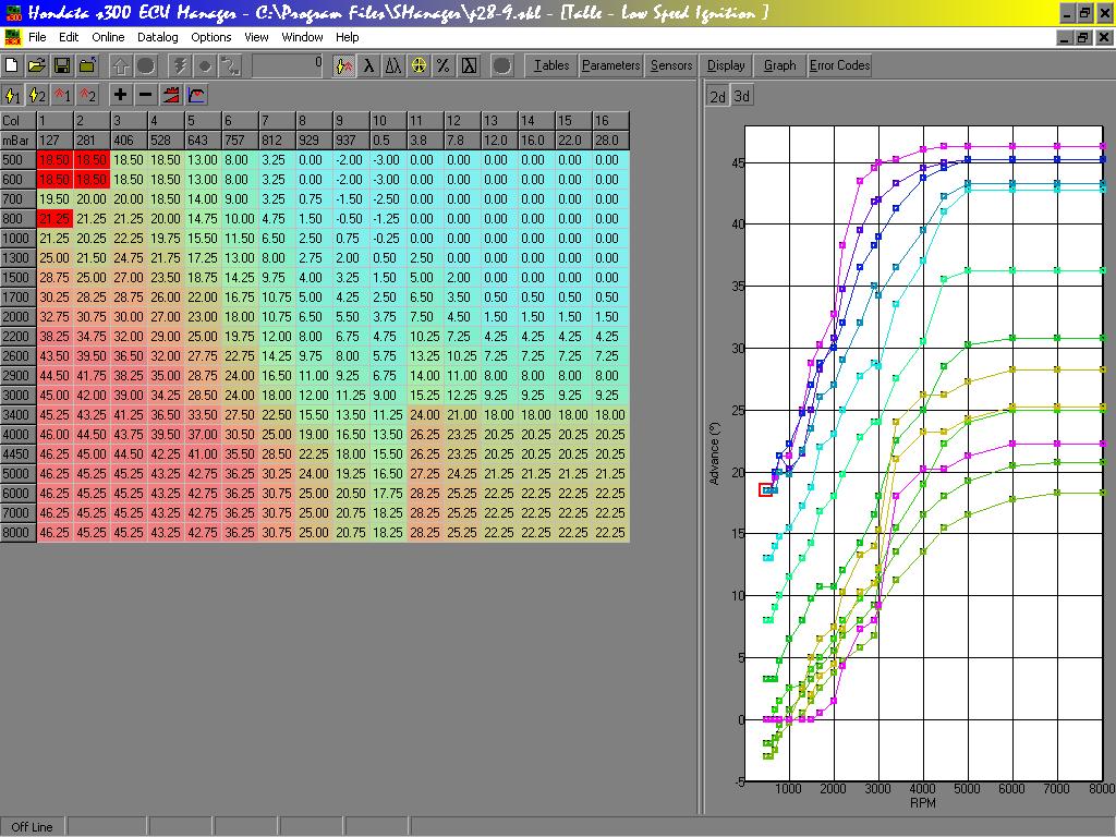

I am not used to the Megasquirt console yet. Still working on my experimental MS car. Here is the way my maps look in Hondata. I find this program much easier to work with. My scale uses Mbar and PSI. You should be able to run without the "dip" since you have a TPS and much better ignition control than the early Bosch stuff.
That map looks about right. As you can see from my ignition map below I also run lots of timing at part throttle and light load.

Go out and try something. Take your 15-25% throttle cruising range and lean it down to 16:1-17:1. Crank your timing up to the high 30s to mid 40s and see what happens. Up your accelerate pump feature for that range of the map, so that you can help the transition from cruise to medium load range. I am talking about the range where your engine runs when climbing a slight grade, maybe 8% or so.
