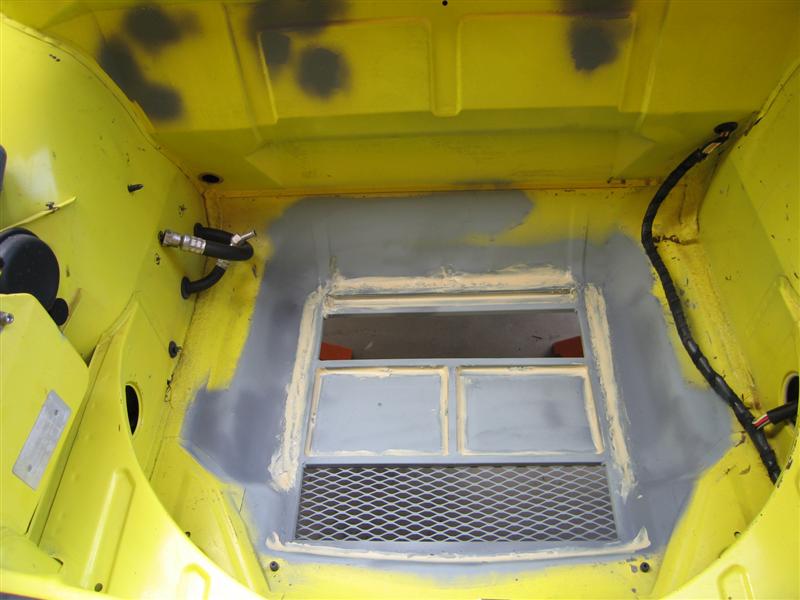

What kind of seam sealer do I want to use? I finished my hell hole patching, and I want to seam seal my welds. At the moment they are just por-15ed to keep them from rusting.
What should I use?

Origionally I had not intended to.
I had read here somewhere the welds tend to wick up moisture even if they are painted. Also, the vids of the guys building that Datsun 240Z have them using seam sealer - and i have learned a heck of a lot from watching them work.

3M Seam Sealer. The sealer is not to seal the welds, it is to seal the cracks between the welded panels, or any imperfections in the welds. I am disassembling my 914, and the areas that had seam sealer were much better protected than the areas that did not. I am putting the 3M stuff back. Using the brush on variety. Good luck. Joe O.
