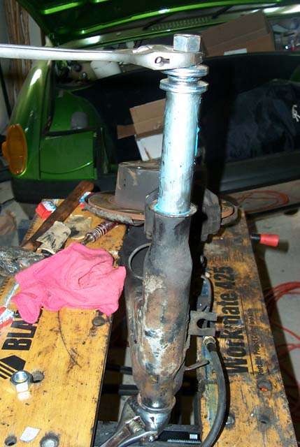

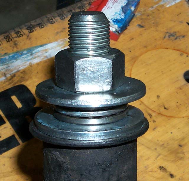

Here's the setup I used to assemble the rear bearing race into the trailing arm...
Big jack screw, grease, and heat on the trailing arm housing.
Note the setup here. 5/8 FINE thread rod and thrust bearing sandwiched in there. I'd hate to pull that race through the arm without the thrust bearings because the torque was pretty high at times. Both ends of the threaded rod were tooled up the same.
