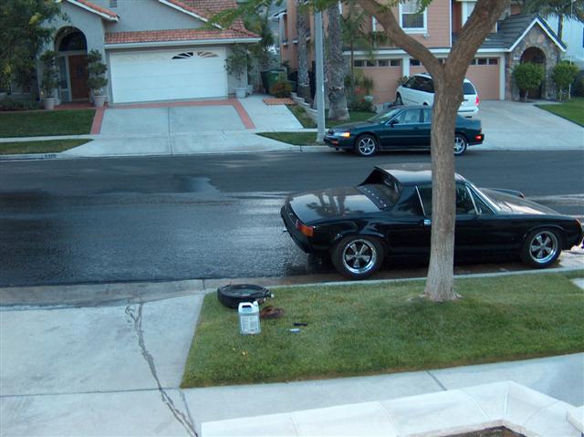

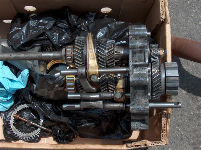

the stack!
![]() the cleanup (water and soap) ![]() |

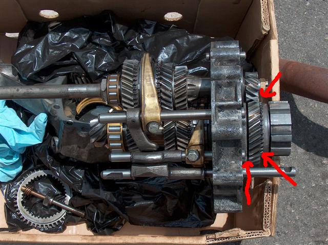

LESSON LEARNED: DO NOT ASSEMBLE INCOMPLETE TRANNIES FROM A BOX OF PARTS (IMG:style_emoticons/default/smile.gif) (IMG:style_emoticons/default/chairfall.gif) here was the problem.... first gear had an "offset" , making it stick out too far, and had the wrong NEW dogteeth on it.... (911).... so we swapped a first gear from a 914 and works great. Attached image(s)
