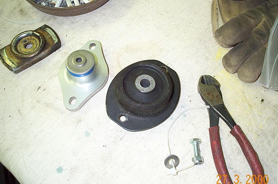

Britain got us some Wevo trans mounts in hopes of tightening up the shifting a bit.
Having got my weekend yard work (it never ends) done while it was cool, I shifted to car work (that never ends either). The Wevo mounts passed my personal "nice piece" test....unlike some other stuff.

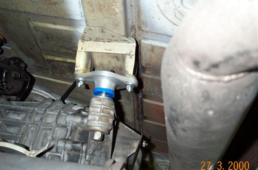

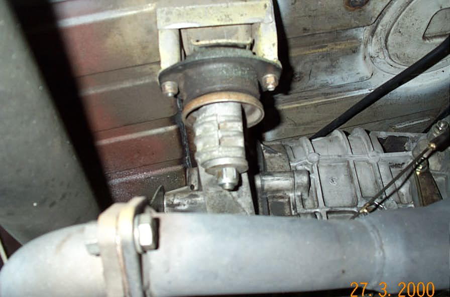

First, a before pic, then a comparo,Wevo to 914/6 trans mounts. Then an installed jobbie....less tightened nuts. These save about 2lbs of weight. Every little bit helps....

Also how do you install these? Do you just undo one at a time and install the new one? Do you have to jack up the tranny?
The mounts are semi-gone (IMG:style_emoticons/default/biggrin.gif)
Yeah, you'll need a jack. To get the old ones out, you have to drop the trans 1/2-3/4 inch.....I tried to do it without....no joy. I've been known to make things more difficult
than they need be, tho. (IMG:style_emoticons/default/huh.gif)

That's why I gave you the pic.....to see if you could tell the difference (IMG:style_emoticons/default/biggrin.gif)

Jeeze....look at the pic.
The 4 pooper mount has holes thru the rubber doughnut.
The sixer is solid rubber.

I don't have any 4 banger mounts around or I'da done that.
Cranky in my old age? .....no, I've always been this way.
I gotta admit that pic is the first time I've seen a 6er mount on the internet......wherefrom (apparently) all knowledge springs.
