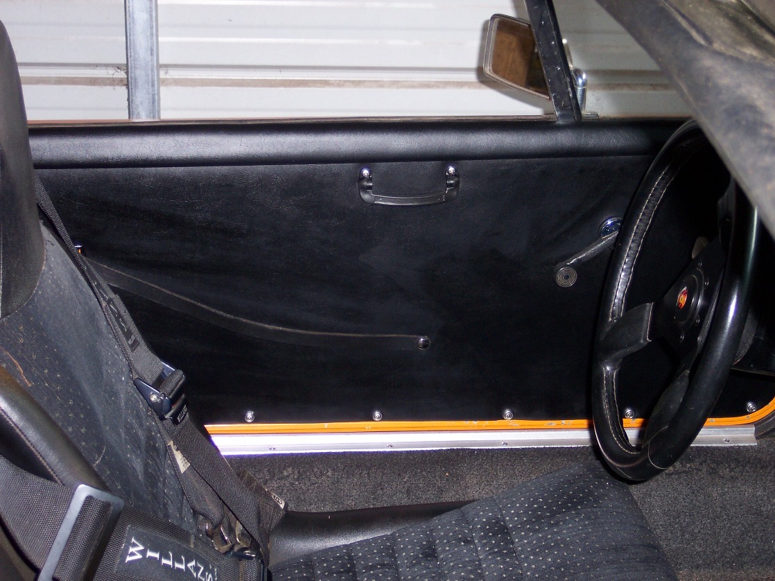

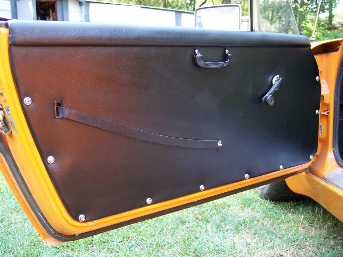

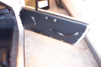

Installed a fresh set of Gt styled door panels on the teener over the weekend.
I got the confidence,following Aaron's thread,as he made it seeem soooo easy.Yeah right.
Well Aaron,the recover went real well til I got up to the tuck & roll.It kicked my A@* so bad,I threw in the towel,and let a local upholster finish the job.
I initially got 2 sets of door pulls to compare prices.Cheapest was from fiatparts.com 20 bucks for the pair.
The leather door strap was made by a local leather guy,6 bucks for the pair.

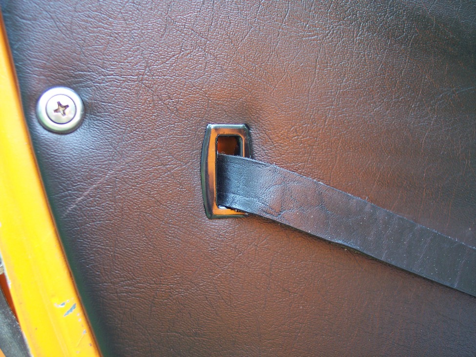

Finally,the bezel for the door strap I copied from AJ's site cause he actually has measurements for it.I lasered it here at work,and made a forming die to hammer it's shape.
Not a lot in it,but at least it is finally done.
Anyway,Aaron's thread is a really good one.Thanks for writing it.

ron!
looks killer! glad my writeup was of *some* assistance!
how did you fasten the screws? i mean, what are they biting into? i ithink i may copy you on that....
also, i would be interested in some bezels (IMG:style_emoticons/default/smile.gif)
looks killer ron.

I'm gonna give it a good try.
The hardest part about making to bezels,was adding extra material to the tabs after they were formed inward.
You see,even after the center portion was formed to make the"hole"that the strap goes thru,there still isn't enough material to go thru the door panel,and the bend the tang around the back side to hold the bezel securely against the panel.
I tackwelded a couple of extra strips to the tang,and then they formed around the back.Then I painted everything semi-gloss black for appearance.
It came out ok,but still a small PITA.
Ron

ron, show mw the rivnut tool (IMG:style_emoticons/default/smile.gif)
I am SOOO going to copy your "bolt on" mounting technique
