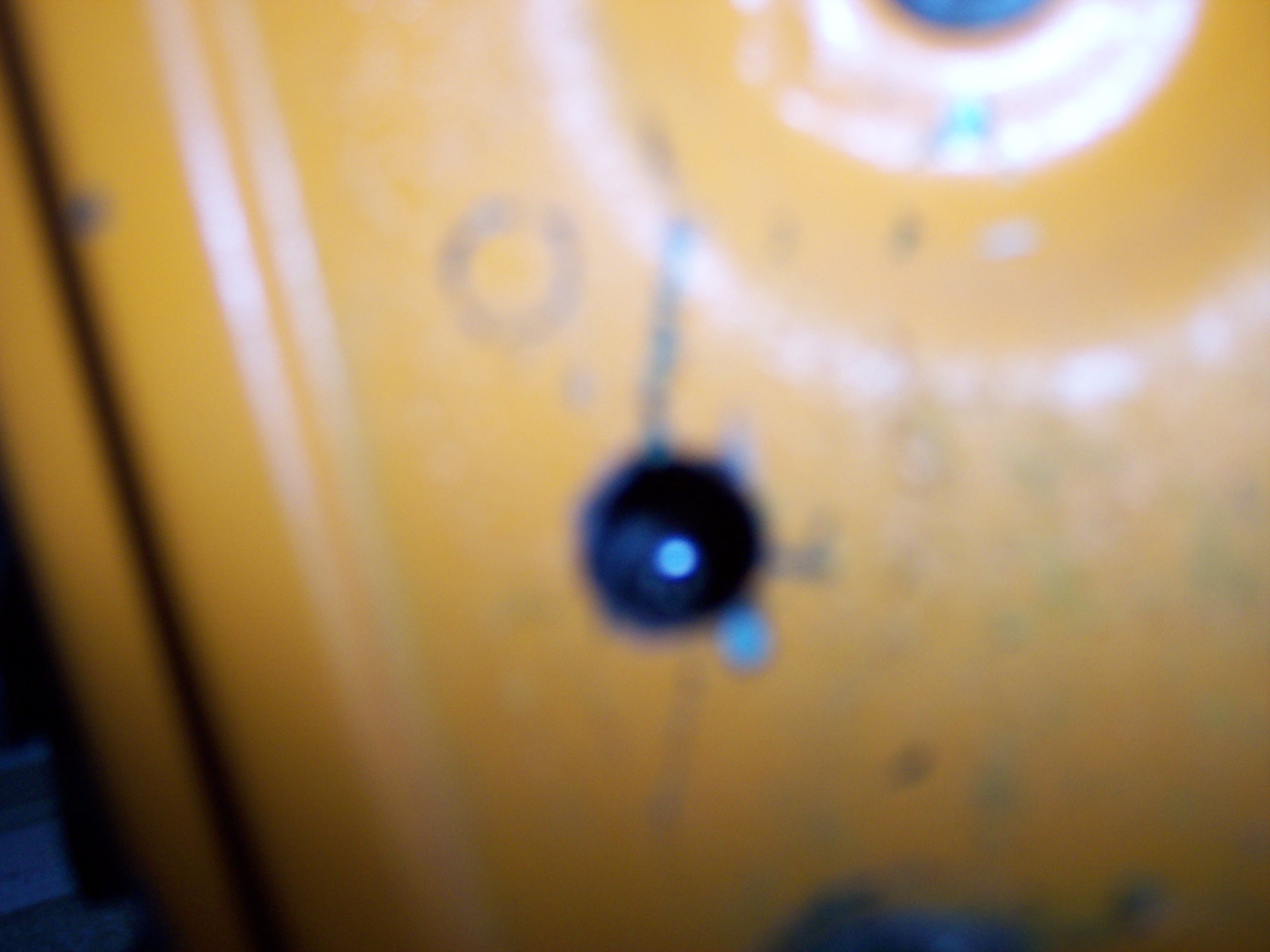

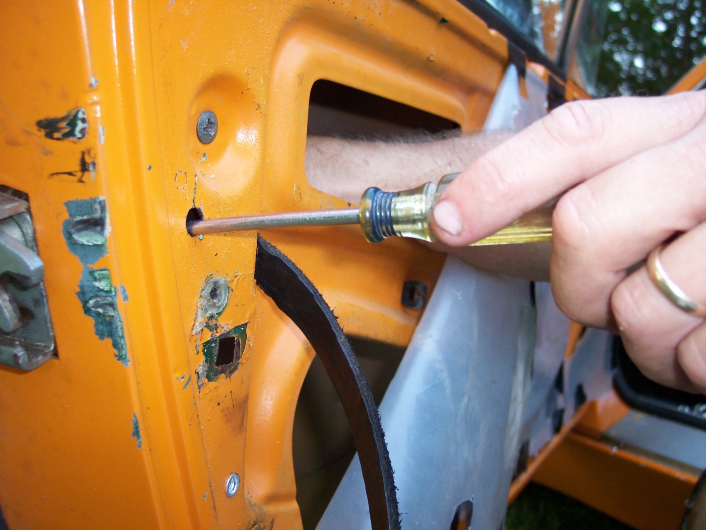

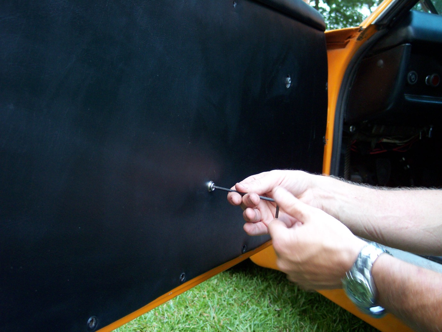

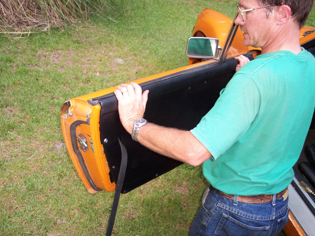

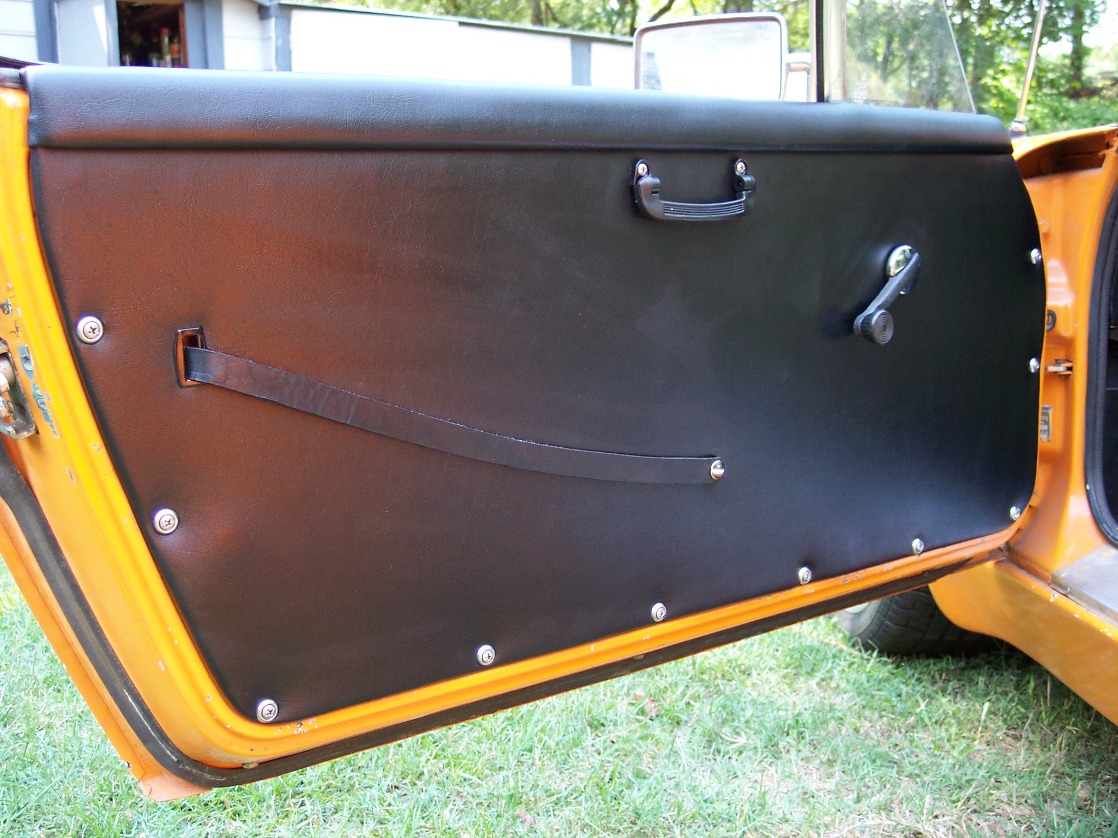

Installed a fresh set of Gt styled door panels on the teener over the weekend.
I got the confidence,following Aaron's thread,as he made it seeem soooo easy.Yeah right.
Well Aaron,the recover went real well til I got up to the tuck & roll.It kicked my A@* so bad,I threw in the towel,and let a local upholster finish the job.

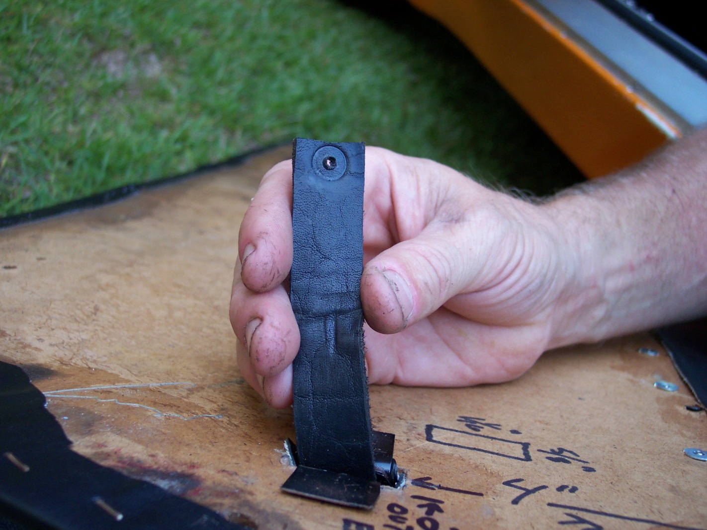

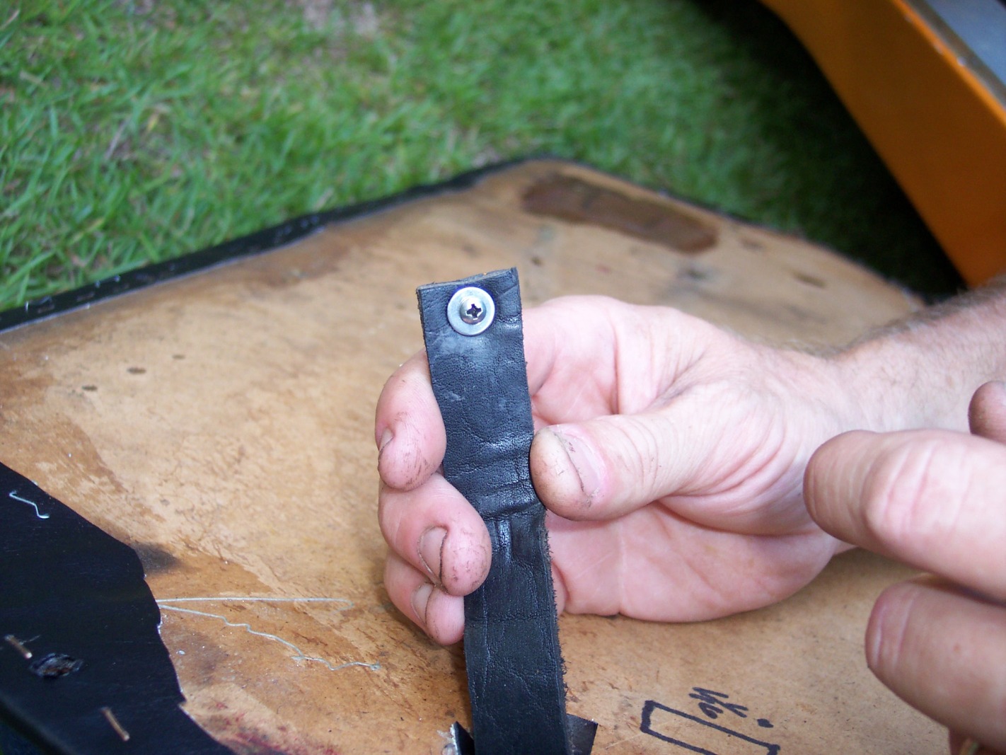

I initially got 2 sets of door pulls to compare prices.Cheapest was from fiatparts.com 20 bucks for the pair.
The leather door strap was made by a local leather guy,6 bucks for the pair.
Finally,the bezel for the door strap I copied from AJ's site cause he actually has measurements for it.I lasered it here at work,and made a forming die to hammer it's shape.
Not a lot in it,but at least it is finally done.
Anyway,Aaron's thread is a really good one.Thanks for writing it.
