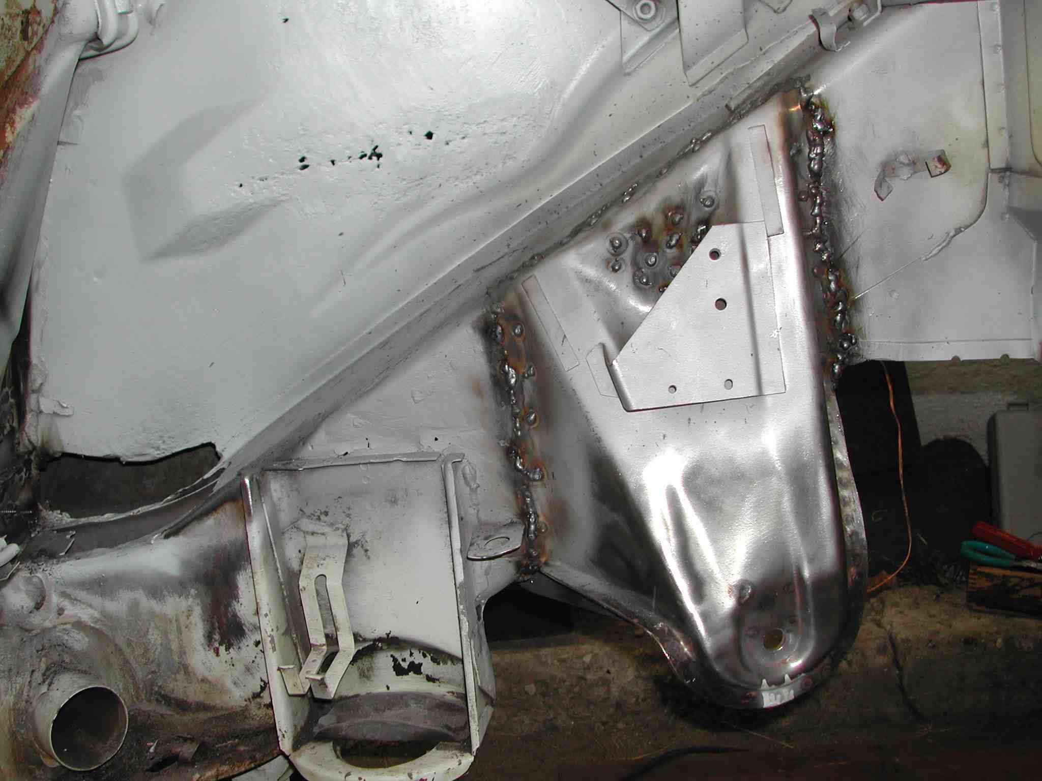

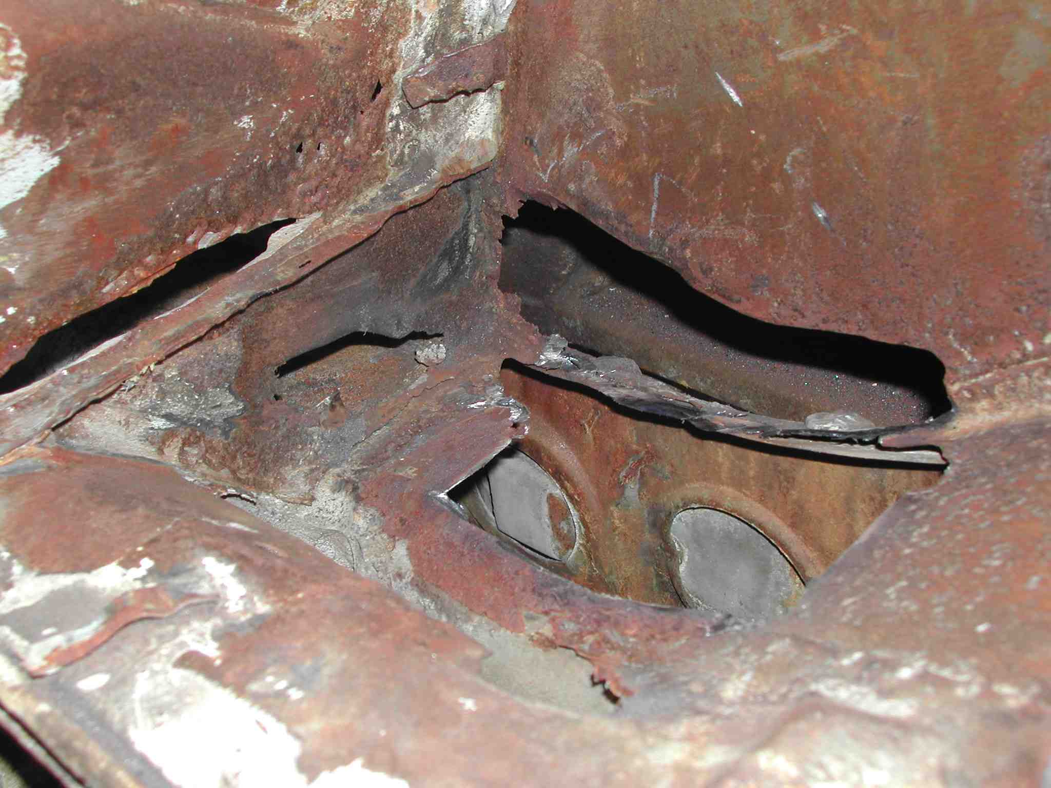

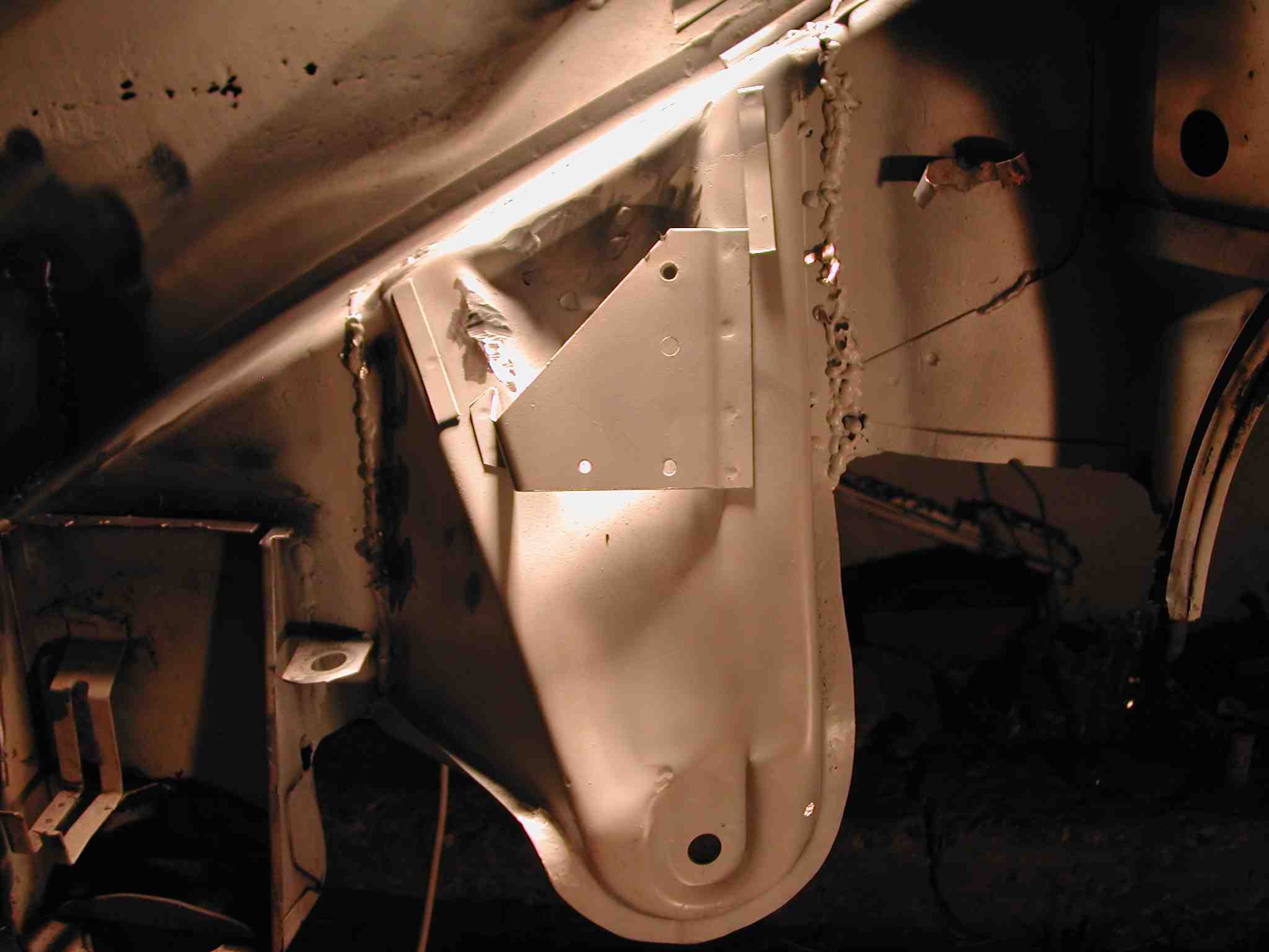

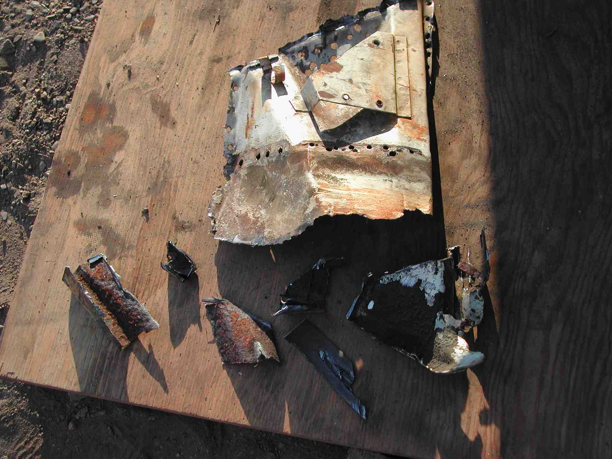

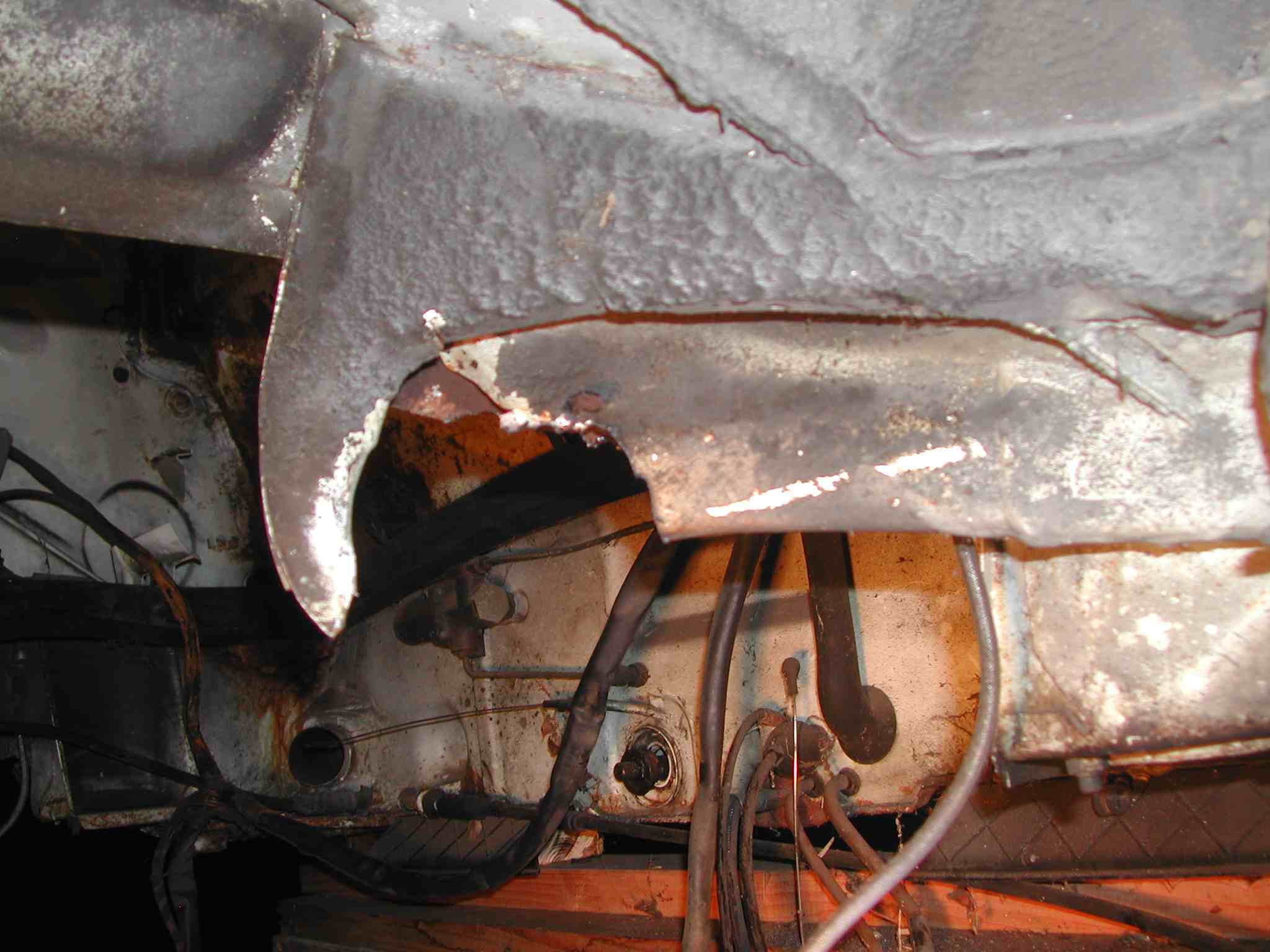

Here is what was left of the Suspension Console.
view from the engine side
highways   Porsche Restoration Factory@ the Ghetto Garage in my alley   Jun 27 2006, 01:40 AM

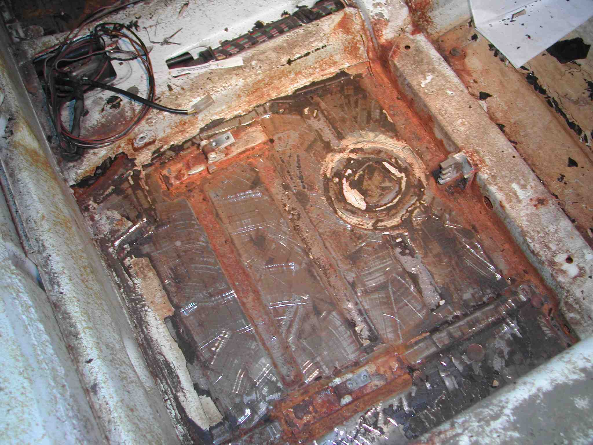

highways   hell hole looking down hell hole view from...   Jun 27 2006, 01:51 AM

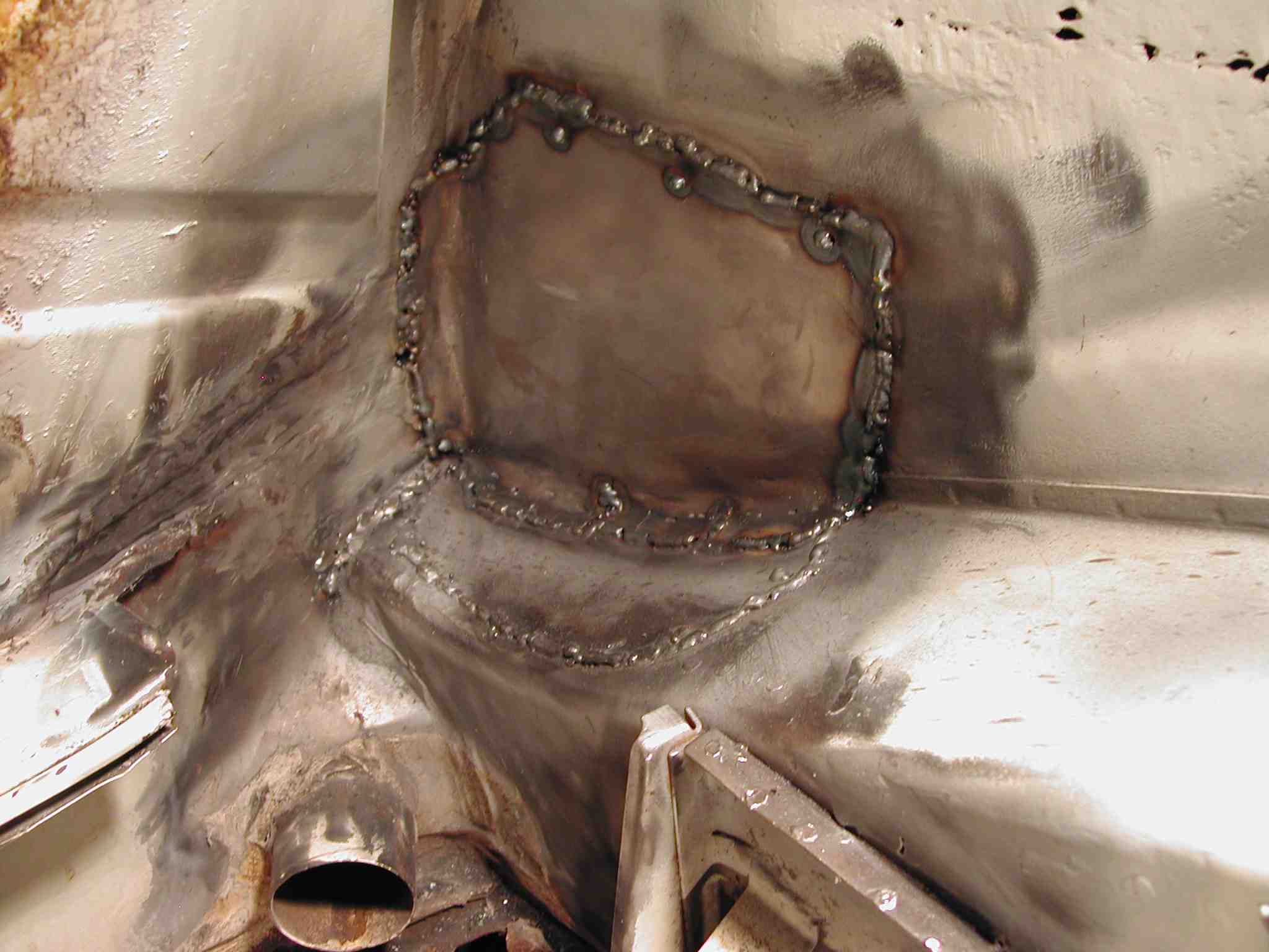

highways   This after I went Ape Crazy on that :stromberg:...   Jun 27 2006, 02:04 AM
highways   Yes it's getting hot in here... It smoked ...   Jun 27 2006, 02:08 AM
bottomend   Great picture... now put the bong away and get bac...   Jun 27 2006, 02:48 AM
highways   Yeah it already started to rust again... 12 hours ...   Jun 27 2006, 03:05 AM

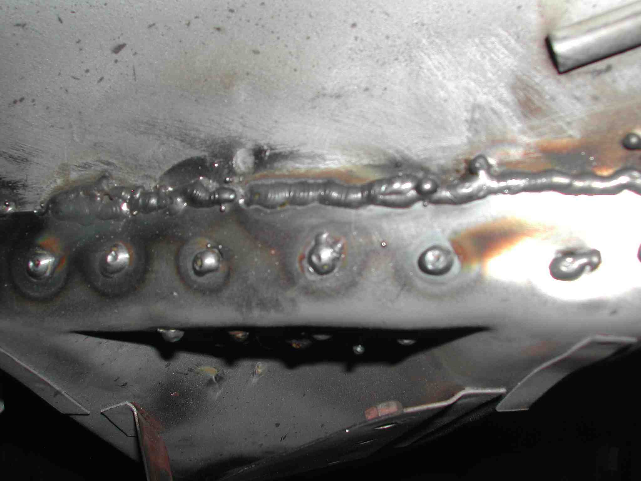

SirAndy   well, about time you got off your lazy butt! ...   Jun 27 2006, 02:14 PM
TimT   Wear eye protection when using that angle grinder...   Jun 27 2006, 02:17 PM
So.Cal.914   I don't know about weldable primer, you do nee...   Jun 27 2006, 02:38 PM
highways   Yean you got it... it's the memories of how fu...   Jun 27 2006, 02:48 PM
SirAndy   weldeable primer works good *after* you cleaned ou...   Jun 27 2006, 02:54 PM
Toast   Ruuuuuuuust! :wince: It's gonna be a clo...   Jun 27 2006, 03:04 PM
bottomend   Acid is fun to play with but I dont know if I...   Jun 27 2006, 04:19 PM
highways   Proto31 likes his Muriatic in a sprayer... says it...   Jun 27 2006, 04:56 PM
