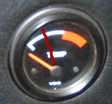

My oil temp gauge seems to max out near the line drawn in the pic (maybe even a little below it), even after I've been running it for awhile, such as 45minutes at 70mph in 4th/5th on the expressway or an hour long fun run at 30 to 65mph in all gears. Or could it be staying that cool?

console oil temp gauge is generally viewed as a ballpark temp, not super accurate. if you wanted to really know, there is a company, imagine auto i think or something close to that, that sells a thermometer dipstick. you could calibrate your console gauge with the dipstick for better piece of mind.
yes, the console voltmeter does deflect with turn signal flashing.

My stock and freshly refreshed 73 2.0's Oil Temp Guage runs just a bit less than your indicator, when moving. Of course, it will creep up a bit if in a long idle, but never gets near the Red area of the guage. And I had it checked when the engine was redone so got to believe it is working relatively correctly.

You could drop you sender in a pot of boil water and see what the gauge tells you. You'll know what 212F look like anyway(and that's around the top of the safe temps). I'm not sure if this is really a good idea, but I'm going to do it next time I change the oil.

Wow mine will only go about half of where yours is at most, guess it runs really cool (or is really off) My volt guage also bounces when blinker is on.
