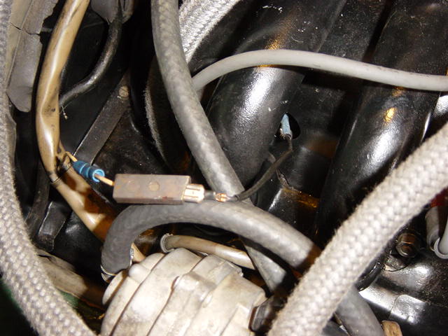

Hi folks,
My '73 2.0 starts and runs fine until it is warm. Then it really starts running rough. If I kick up the rpm's, it seems to help some, but not much.
I've pulled a couple of plugs and they are somewhat sooty.
I've disconnected the Temp Sensor II (CHT). When I connect my multimeter to the connector and touch ground, I get zero ohms. From what I've read, I was thinking that this should read 2000 - 3000 ohms when cold (albeit it is around 80 degrees in my garage). The sensor's connecting wire does not appear to be touching anything.
If the sensor is bad, would this contribute to the car running rich?
Thanks,
Chris
