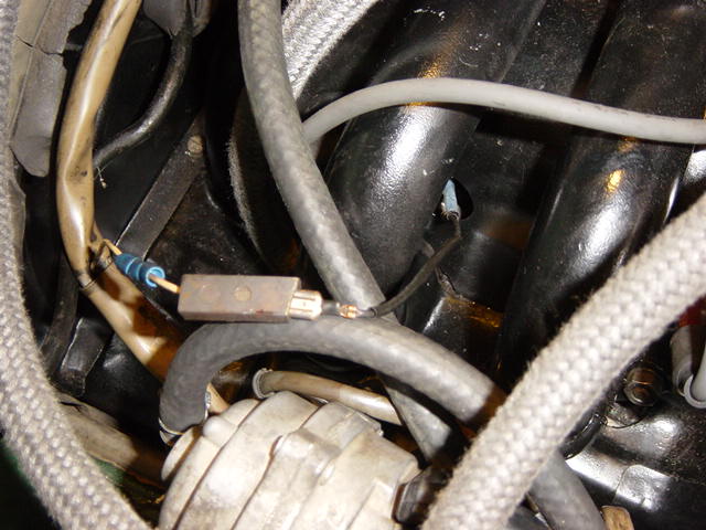

Since I really don't know fully what I'm doing, I figured that I'd take a picture.
The sensor feels like it is seated tightly. I continue to measure zero ohms when testing from the lead's connector to ground. And when I disconnect the wires shown in the photo while the car is running, the engine stops dead.
First, am I connected to the correct wire? It is in the harness just after fuel injectors #3 and #4.

I don't see the 270 ohm resistor. It's supposed to be the first thing that the wire from the CHT sensor plugs into, and then the other end of the resistor plugs into the harness. It looks like your CHT is plugged directly into the harness. The resistor is cylindrical, about 2 inches long. Mine is green, with 270 ohm printed on it in white. Sorry no pictures.....
