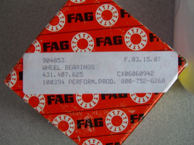

I've searched the web for rear wheel bearings and find that Performance Products has the best price that I could find but don't they say who the manufacturer of the bearings is. I want to stay with a US or German bearing. Does anyone know if Perf Products bearings are quality bearings?

Just got these for my '73 2.0. (IMG:style_emoticons/default/smile.gif)

Buy it from GPR. PProds bearings are probably German or Swedish, but why support a megacorp that barely cares about 914s? BTW, "American" bearings are likely to be reboxed European parts. FAG or SKF are the generally available and good quality parts. The Cap'n
