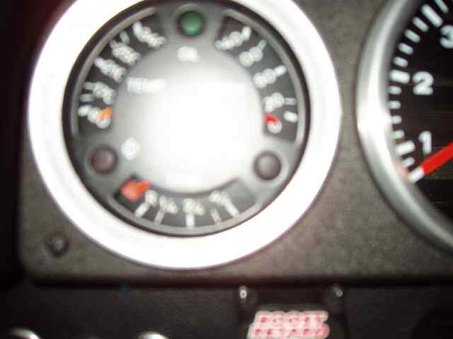

i just helped the needle a bit, when my gauge was unpowered the needle was pinned all they way to the left now it rests at the left side of the reserve light panel.

Hey Iamchappy - I recently fitted a new gauge, as above when unpowered it sits far left on it's stop - should I move the needle so it sits just below minimum, when unpowered?
I'd prefer it to read wrong at max rather than minimum :lol:

I just ran out and snapped a blurry picture of it. It rests on the right side of the reserve light panel now. Before i moved it, it was on the left side of it which made up for the 1/4 tank error..
