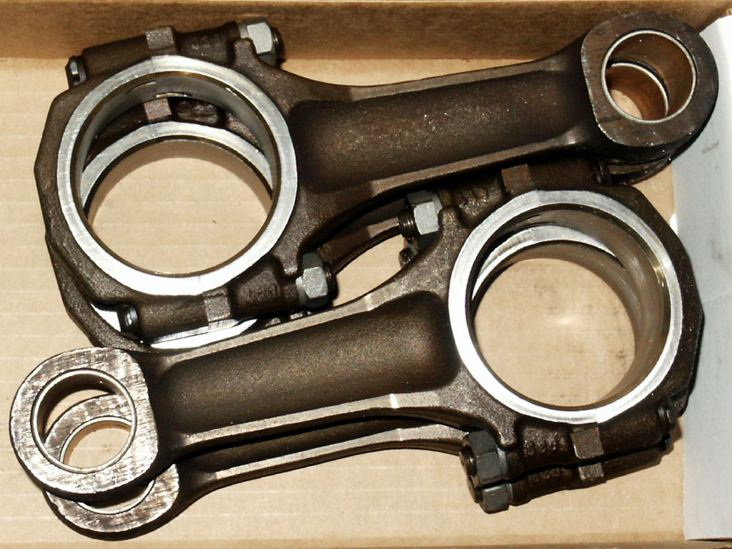

Closeup of refurbed rods:

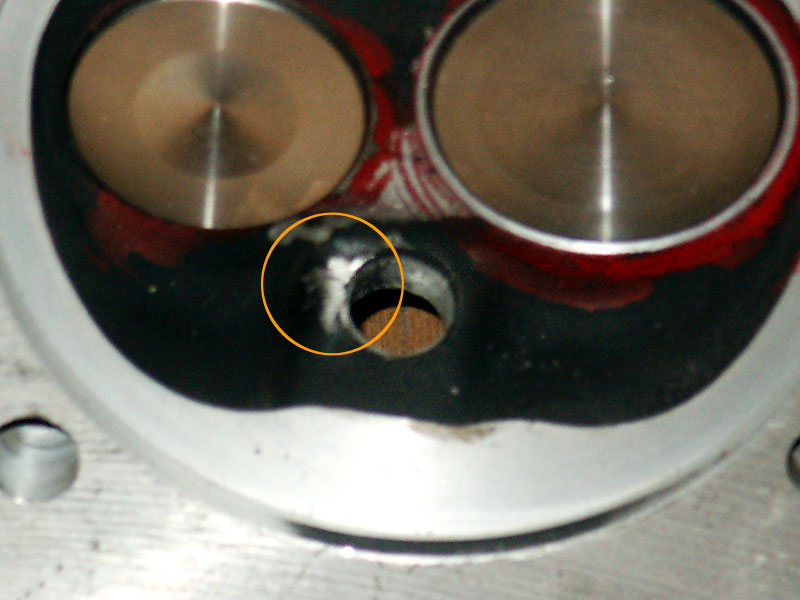

Unless my eyes are playing tricks on me....
I spy a crack heading toward the exhaust seat from the plug hole in the last pic that was posted... Its the register on the right.
Please tell me that its not there and that the machinist didn't allow the head to leave the shop without being repaired..
It could be in the picture only- I hope so..
bd1308
post Sep 12 2006, 07:14 AM
Post #23
Sir Post-a-lot
Posts: 8,020
Joined: 24-January 05
From: Louisville,KY
Member No.: 3,501
Yep. I see something like a crack too.

Wow... I didn't even see that! How could you even tell from the picture? I looked and looked and looked at the head (and picture) and couldn't see anything. Then I busted out a emry board and just lightly went around the spark plug hole.
(IMG:style_emoticons/default/sad.gif) $$$$$$ (IMG:style_emoticons/default/sad.gif) I wonder how much this is gonna run me to fix. I'm not going back to RIMCO for anything more than a valve job, so where to go? RAT? FAT? Clayton's guy? Mark Henry? I'm boned and broke. Maybe I'm just destined to have this engine exceed the $6k mark because of tons of little shit like this. First the bottom support on one case half for the windage tray is fuct, now this. (IMG:style_emoticons/default/dry.gif)

Jeez, It's like Jake smells imperfection...
Sorry to hear about that... at least it was caught before your 6k engine disentegrated itself...... (IMG:style_emoticons/default/sad.gif)

I know where to look- I do this everyday, all day- 18 hours a day generally.
Any shop that lets a visual crack leave their doors needs to be closed down for incompetence! generally Rimco will not do this, but tyhey should have at least told you and let you make the decision as to the repairs to be made.
That crack tells me there are other cracks that can't be seen.. If you heat that head up to about 300 degrees you'll find more- guaranteed. When the chamber cracks its a tell tale sign of more issues.
This is why we refuse to use any rebuilt heads on our engines and have for years, we start with a new casting and go from there..
Pack that head up and send it to HAM.....
BTW- my most expensive sub 2.3 L engine kit costs less than 6K- FYI
It comes with BRAND NEW super duper heads.
projects that begin with compromise, end in demise... Don't be a statistic.
BTW- this isn't the first time I have seen cracked heads posted on this forum from shops. A lot of local machine shops think "Its just an old VW engine, I'll let it fly".... They need their asses taken out in the woods and tied to a tree while being beat twice every hour for 3 days. Bastards.
Don't trust ANYTHING you get from a local shop, have every journal measured, rebalance the rods and check the fit of the wrist pins.

Len is the man and send him BOTH heads to inspect.

ouch brando....
rimco did a valve job and seats but didnt point out the cracks?

Wellp, just took the heads back to RIMCO. Says they should only charge for spark plug repair and broken stud removal (yay). Now, where can I get stainless studs for intake/exhaust?

uh... welding on the plug boss and remachining it requires seats and guides to be done again no?
heat of welder does wierd things to seats and guides....

After welding all the important surfaces and tolerances must be checked. Generally the seats will need to be recut and the registers surfaced.

Yes. All the work I had done previously will be re-done (no extra charge). I'll only be charged for the studs and what the normal cost of spark plug boss repair is, not the rest of the machine work that is being done again.

Brando, Either walnut shell the combustion chambers or solvent/scrub them yourself. Heat em up and see what ya really have.
Use some NDT dye penetrant on the heads and see what cracks are really there. (McFadden Dale) (I like Zyglo brand myself)
Now that YOU have seen what cracks are in the castings. You can make sure RIMCO did their job.
Bro, they can't fix what they can't see. And too often they DON'T clean the parts well enough to look. (as in your case)
I suggest YOU point out EXACTLY what you want them to do. Then hold them accountable for the work.
