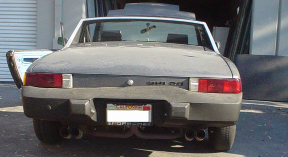

I took my wife for her first ride in my Teener. (IMG:style_emoticons/default/driving.gif) She was not happy with the noise volume. What are my options when it comes to quieter mufflers? I’m not sure what I currently have but I’ve been told that it is not stock. I also know I have an exhaust leak.
My Teener = 1975 1.8
-arron

QUOTE(poohsan @ Jul 23 2006, 10:44 PM) *
-arron
Carbs or stock injection? Is the sound pad still present on the engine side of the firewall? Do you have any exhaust leaks? Looks like you're running the Monza four-tip exhaust. It's louder for sure, and is really raspy compared to a Bursch setup's deeper tone.
My current teener has a Bursch muffler with the stock 2.0 D-jet injection and I can't believe how quite it is compared to my '71 that also had a Bursch, but that had been converted over to dual 40 IDF carbs. Intake noise was fun around town, but that much noise made normal conversation a burden and was also rather fatiguing on longer trips (geez, am I getting older or boring?).
Stock hotdog mufflers are heavy.

QUOTE(McMark @ Jul 24 2006, 10:17 AM) *
I agree with Randy, and add that if your Bursch is loud it's probably rusted out. (IMG:style_emoticons/default/wink.gif) They are very quiet when new. The engine bay sound pad, although a water trap and despised by most everyone, is VERY effective at reducing the sound in the cabin. I get phone calls from a few people while on the road and I can't even tell they're in their 914 or a brand new car. It helps so much.
I never said that he has a Bursch, but was just sharing the experiences I've had with them. He has a four-tip Monza. (IMG:style_emoticons/default/tongue.gif) The Monza mufflers I've seen are usually half rotten, and I'm surprised to see all four tips still attached on his.

Your current muffler with the up swept tips looks like an Anza to me, I have the same
on mine. Yes it is loud but motorcycles run loud pipes for saftey (IMG:style_emoticons/default/wink.gif) and I like the
tone.

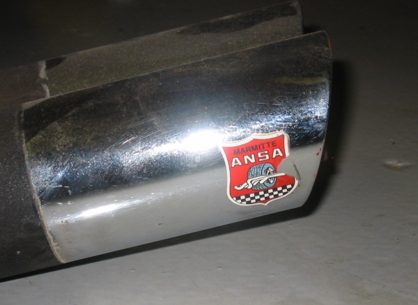

ChrisFoley
post Jul 24 2006, 06:38 PM
I am Tangerine Racing
Posts: 8,019
Joined: 29-January 03
From: Bolton, CT
Member No.: 209
I'm pretty sure the 4 tip muffler I recently removed from a car at my shop says ANSA on it.
RoadGlue
post Jul 24 2006, 06:44 PM
Sonoma County Gear Head
Posts: 2,034
Joined: 8-January 03
From: Santa Rosa, CA
Member No.: 108
QUOTE(Racer Chris @ Jul 24 2006, 05:38 PM) *
Waaah? You wouldn't dare to say that I might be mistaken, WOULD YOU?!?!?!?
Ok, so I might be mistaken. (IMG:style_emoticons/default/ohmy.gif)
