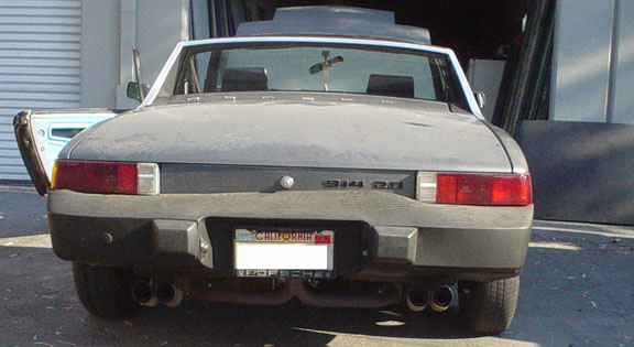

I took my wife for her first ride in my Teener.
She was not happy with the noise volume. What are my options when it comes to quieter mufflers? I’m not sure what I currently have but I’ve been told that it is not stock. I also know I have an exhaust leak.
Click to view attachmentMy Teener = 1975 1.8

the factory muffler works well.....next would be a Bursch....the unit you have are known to be loud and rust and be too heavy...

Carbs or stock injection? Is the sound pad still present on the engine side of the firewall? Do you have any exhaust leaks? Looks like you're running the Monza four-tip exhaust. It's louder for sure, and is really raspy compared to a Bursch setup's deeper tone.
My current teener has a Bursch muffler with the stock 2.0 D-jet injection and I can't believe how quite it is compared to my '71 that also had a Bursch, but that had been converted over to dual 40 IDF carbs. Intake noise was fun around town, but that much noise made normal conversation a burden and was also rather fatiguing on longer trips (geez, am I getting older or boring?).

I never said that he has a Bursch, but was just sharing the experiences I've had with them. He has a four-tip Monza.
The Monza mufflers I've seen are usually half rotten, and I'm surprised to see all four tips still attached on his.

Your current muffler with the up swept tips looks like an Anza to me, I have the same

It's my understanding that Monza copied the look of Anza mufflers. Ansa is the real deal, and you'll find them on some of the more interesting Italian and other European cars. However, I don't think Ansa ever made an exhaust system for Porsche/VW.

I'm pretty sure the 4 tip muffler I recently removed from a car at my shop says ANSA on it.
