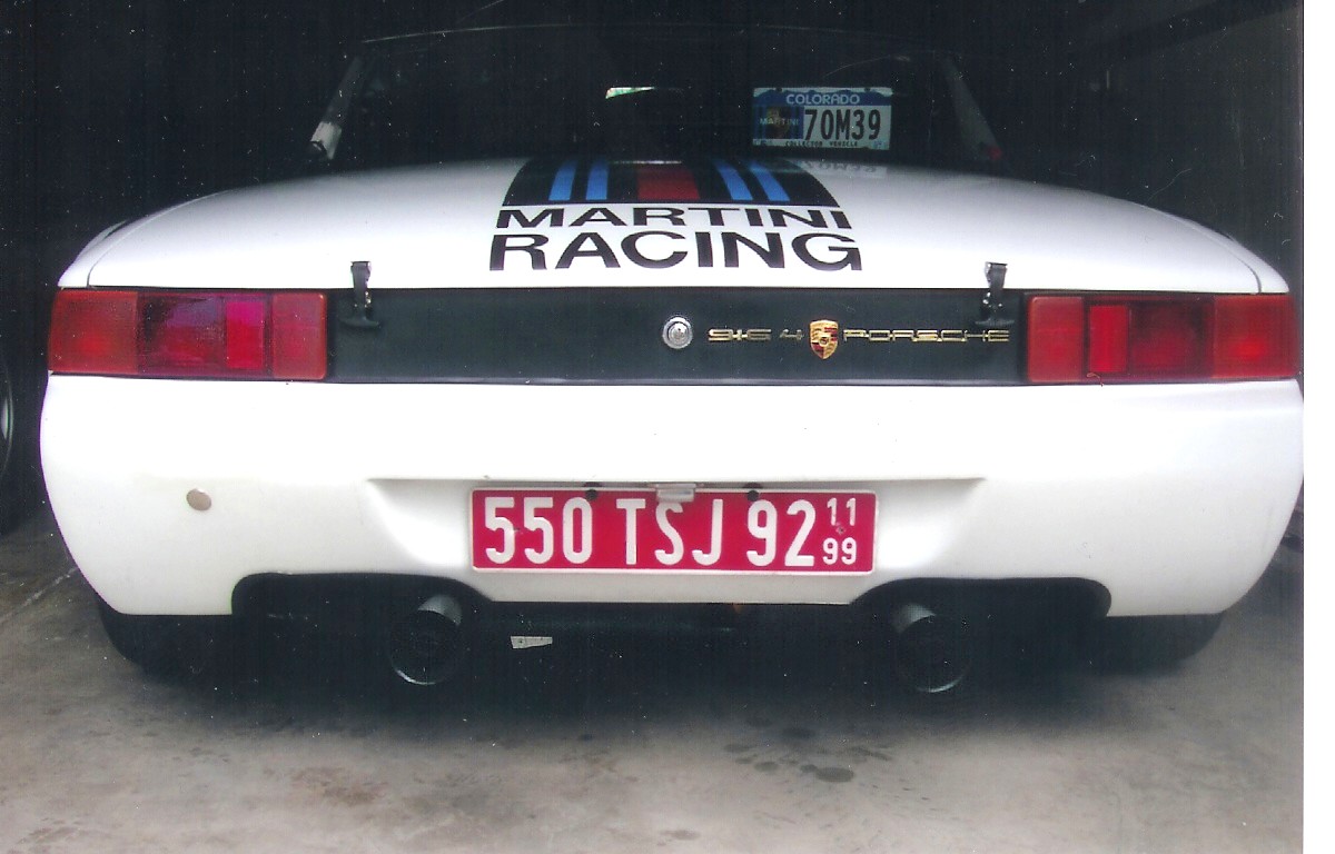

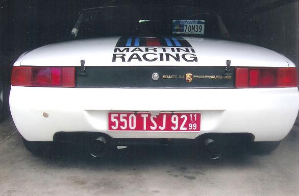

Well it is done. I finished the two mufflers. The first isn't a very good picture, a tad dark and being that it is installed, you cant see a whole lot. It is a stock 1.7 muffler that I cut open to see how it was baffelled (sp) - I will post a diagram of the inside. I then used the same technique of cutting some holes and welding on new tail pipes. The tail pipes were made from race megaphones - just because I liked the look of the "cookie cutter" on the inside. I used a brass freeze plug in the stock tailpipe hole - you can just barely see it between the J and 9 on the attached pic.
Car is actually not to terribly loud - especially at idle. It definitely gets louder as the RPMs increase. Performance wise it is tough to tell. I did notice one thing - if I was on it (3/4+ throttle) and then had to quickly hit the brakes, and then mashed it back down to 3/4+, it felt like it had a flat spot power wise. It was really hot for the drive home with lots of stop and go. I dont not know if that is what was causing this. I did do a quick mixture adjustment, but I still felt it.
One great thing - it was pushing 100 degrees and I was in stop and go traffic - I never got above 190 on the 40 minute drive home!

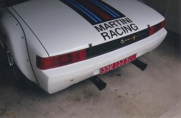

Here is a side view:

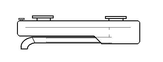

Here is the digram of the stock insides:

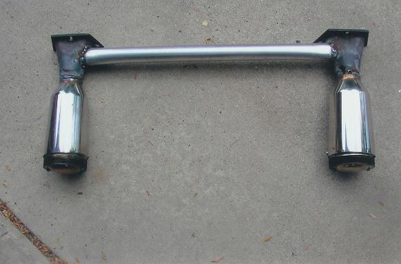

Here is muffler number 2 - we added the cross over pipe. It did make a noticable difference in mid range torque (using the same amount of discs as it had previously). I will put it on the car and start adding discs and see what happens.

I am still getting used to the sound - not sure if I like it or not. Everyone who has heard it seems to really like it - even my wife unit. They all seem to think "it fits" the look of the car.
The megaphones were cut way down so they didn't stick out to far. The holes on the muffler are 2". We welded stub pipes to the cannister, then welded the megaphones over the top of the stub pipes, directly to the cannister. The stainless supertraps are just the normal 8" versions with a 2" inlet and 4" spark arrestor. The manifolds they are mounted to were actually cut from the megaphones.
The motor is just a warmed over 2.0 - euro pistons, cam, dual 40's, MSD - the usual junk. I am pretty sure the car had an engine fire prior to me owning it, and that is what caused the switch to carbs. I put in the new motor in 1996 - just rolled 10k miles.
