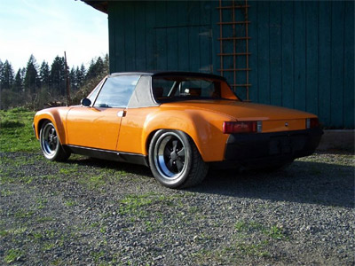

I never got around to spacing the fronts like I wanted to, but the rears I brought out as far as I could. I don't think you could fit a credit car between the tire and the flare. That look ROCKED! (IMG:style_emoticons/default/driving.gif)

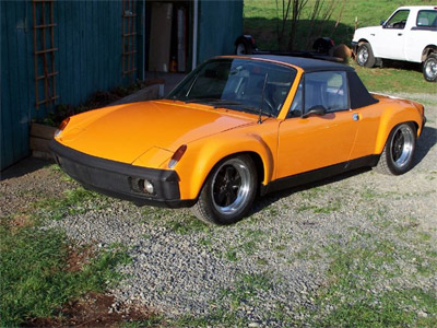

Member No.: 2,105
From the front. I agree with folks stating you want to be careful when spacing the front wheels. You change the turn-in and stearing efforts. Plus you "carry" the wheel out to the flare edge the more you space it. I have a flared 914-6 now that I spent a little time with 2-3 different spacers getting the rim out as far as I could for the "look" without the tire rubbing the flare.
