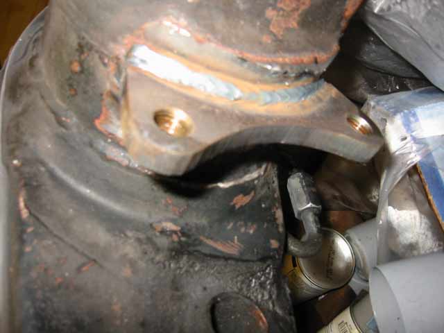

The first is the caliper mount welded up. I am going to post this in the resources section. We can do any caliper offset for 3.5 bolt spaced calipers people want. Set up for solid or vented rotors.

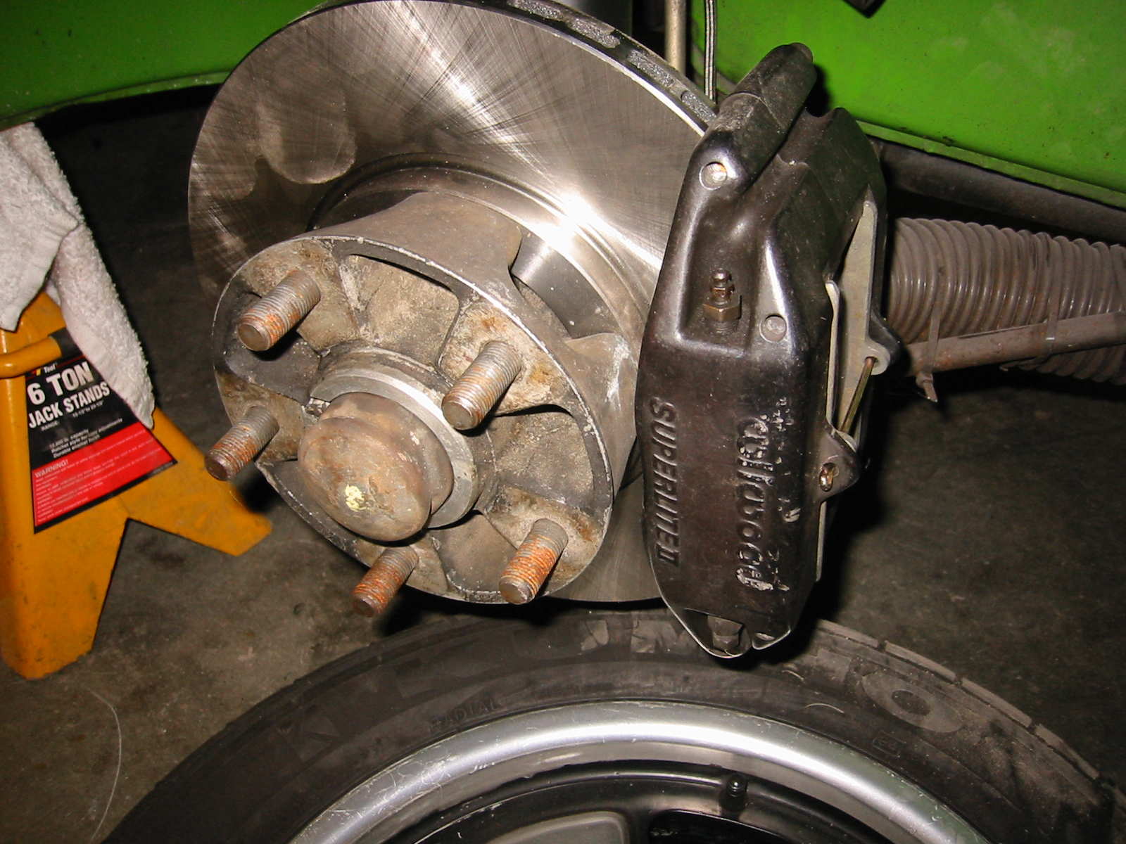

This photo is everything mounted up

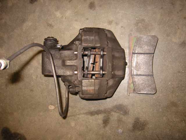

This is a comparison of the new brake pad to the original rear caliper

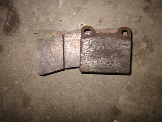

Finally, a picture of the stock size front pads in comparison to the new pad size all the way around.
And another photo of the fronts for good measure

I didn't weight the old calipers or the Wilwoods.
I just looked and Wilwood doesn't list the weight for these calipers, but it list similar ones at 3.2 pounds. The pads are probably .5-.75 pounds each. I can pads tonight if people are interested.
The calipers are pretty light for their size. They are forged billet aluminum.
Matt

(IMG:http://www.914world.com/bbs2/uploads/post-1507-1154112662.jpg)
thats alot of overhang on the pads! is that caliper in the final position?

Pad overhang is a little much!
B

The overhang looks worse in the photos than it really is. They are actually mounted exactly as the Wilwood drawings call for.
As for weights:
The stock non-vented rotor is 8.5 #s
A drilled vented rotor is 12.5 #s
The stock rear caliper is 7 #s
So, it is probably slightly heavier due to the heavier pads. It's more than made up for in increased braking ability.

I don't know about the sixes but the regular 914 is 3in bolt spacing.
How about a shot of the clearance between the caliper and outer edge of the rotor.

They are 3.5" spacing. On the front, you have to add a washer between the caliper and ear. On the back, we have to cut off the stock mount and weld on the new one.
I'll work on some photos of the edge of the rotor to caliper. Spacing is not a problem there.
