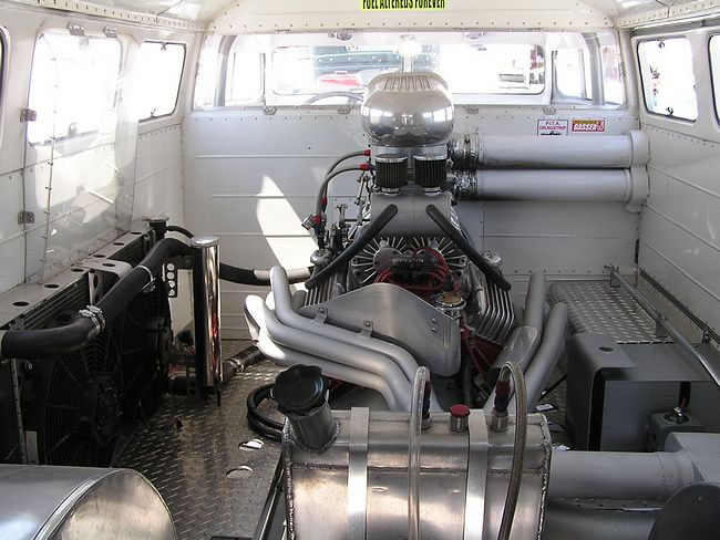

something like this...but hidden (IMG:style_emoticons/default/happy11.gif)

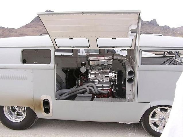

there is a pic of a white one, on the salt flats... HUGE v8 and a sick duct on the side to feed the radiator....
chopped as i recall as well

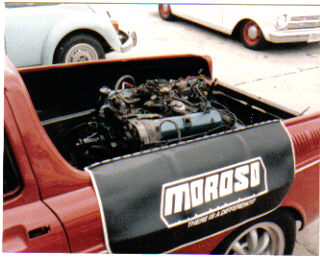

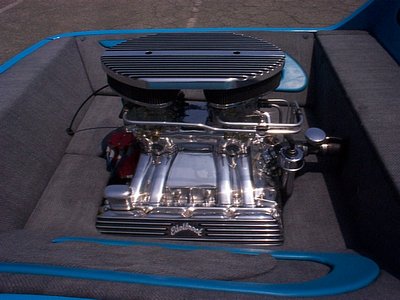

If your going to mount it mid-body, forget the transaxle and go direct into an automatic and 9inch Ford or something comparable. A couple of vans have been built with a separate subframe to mount the engine,trans, and rear. It pivoted off of a long pin all the way thru the frame. Rear shocks ( they were air at the time) like coilovers would do it.When you want to remove the drivetrain you drop the shocks and pull the pin. It was done up like a rolling engine stand, radiator and all. If you want the Toronado setup you will have to fabricate your own mounts. The factory Olds front mount is pretty simple to attatch to, the rear will take a lil bit more ingenuity. I don't have any good pics of the mounts, but here are a couple of it under construction. Also....forget Sway Away axles. Deal with Moser Engineering out of San Diego. He did my axles almost 20 years ago.....no problems.I had him use 9 inch Ford axle stock splined for VW..............Dad (IMG:style_emoticons/default/driving.gif)
