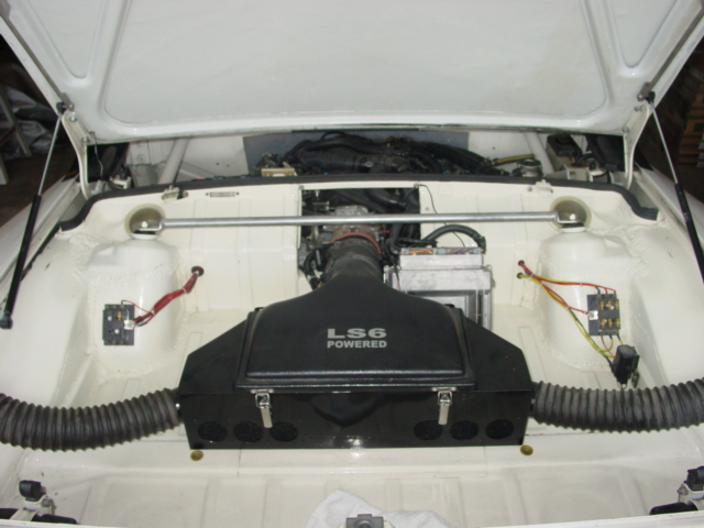

On an LS series motor, you can reverse the intake manifold and now the throttle body points rearward....like on my car.

The rear trunk becomes close to useless due to the airbox and intake hoses, etc. I can put two medium size gym bags back there or one large one...or a small cooler full of beer...(it won't stay cold very long though!)
