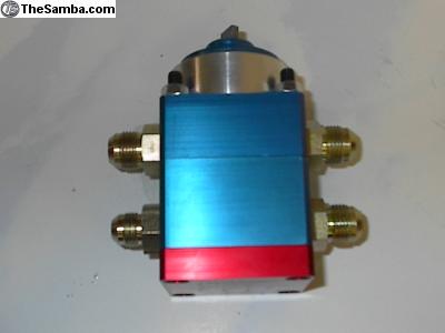

I just picked a lightly used Autocraft two stage dry sump oil pump for a Type IV.
Anyone running dry sump? Can/would you post photo? Got a pretty good idea what I should do, but would would like to know what others have done and recommend.

That pump moves a lot of oil but I'm pretty sure it doesn't fit behind the stock cooling shroud. A company called EuroPerf in NJ makes one that fits with stock cooling.

Watch that pump!
I have seen no less than 4 camshafts snapped in half due to it... The pump drive is sometimes not square ith the pump bore and the added load of those huge vanes makes it more prone to ocur.
Don't mean to rain on the parade, just telling you to watch out!
Also the way that you take oil to and from the pump/tank is critical with a TIV. There are many ways to do it, some work and some don't.
