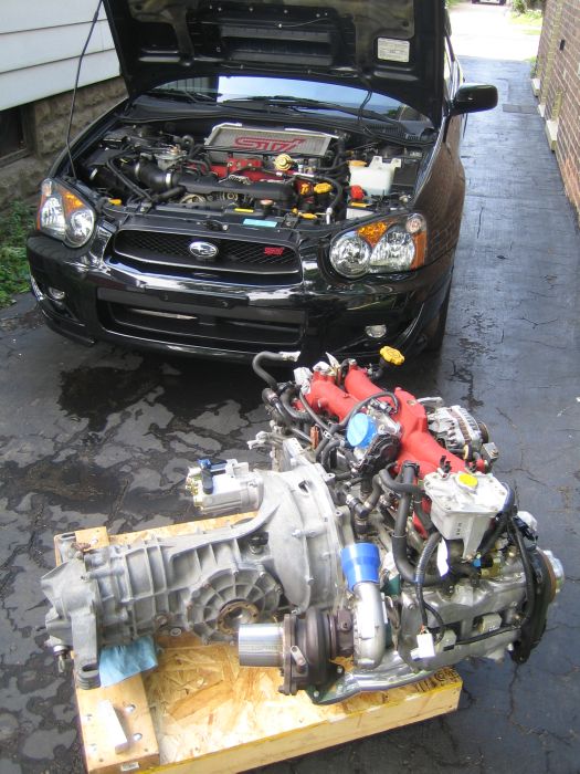

This is the engine that I started with, it came out of my daily driver STi that came to an untimely death:
