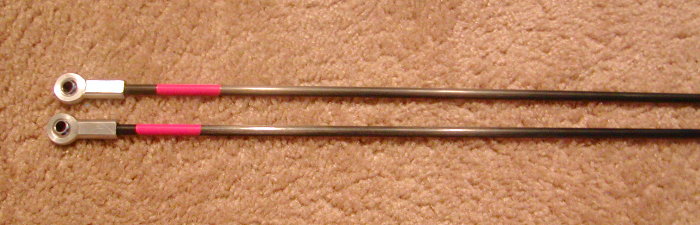

I've bought the Seine System universal kit which has both the carbon fiber trunk and hood supports.
Anyone install these units? It sure isn't obvious where they can go and still function and look clean.
Pictures would be greatly appreciated.
Thanks.

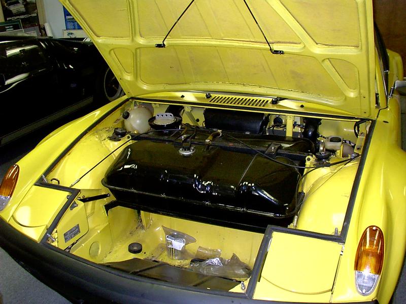

(Front hood) There doesn't seem to be a mounting point on the inter fender that will work, given the curve of the fender, i.e., the rod can't bend around the fender curve when shut.
Maybe the ridge which sits in front of the tank would work (perpendicular to the fenders) and still have sufficient room for the rod to "be packed up," so to speak.
Same issue applies to the rear trunk.

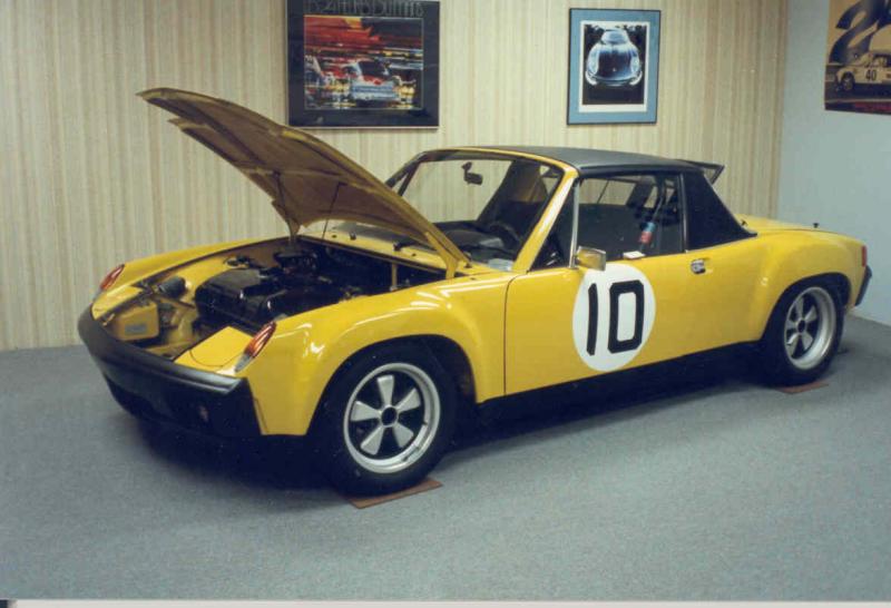

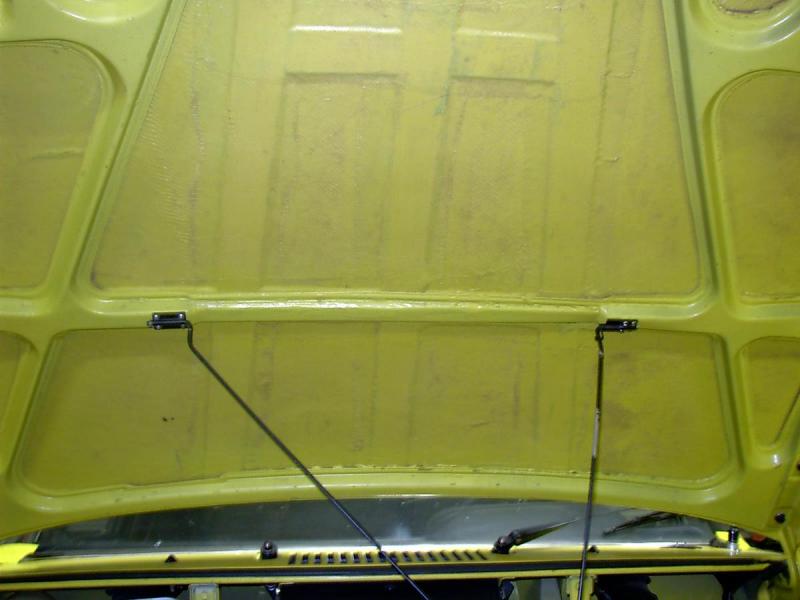

check Armando's site for pics of the original GT hood prop
it's a nice set up, that would be fairly easy to make

Here's the link to Armando's site
http://www.pbase.com/9146gt
These pics give you an idea how it's done
I've seen other/better pics there, but these were the quickest I could find and should give you a good idea
(IMG:http://mishilo.image.pbase.com/u36/9146gt/large/23456221.HBGT2006.jpg)
(IMG:http://mishami.image.pbase.com/u34/9146gt/upload/22398214.HB9146GT003.jpg)
(IMG:http://k41.pbase.com/u36/9146gt/large/23456216.HBGT2001.jpg)
(IMG:http://k53.pbase.com/u34/9146gt/large/22398210.HB9146GT000bGagnonotherphoto.jpg)

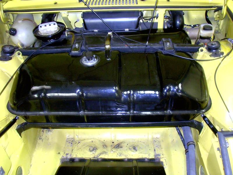

How about on the bulkhead in front of the tank? Not sure how long it is etc... sideways mount there??

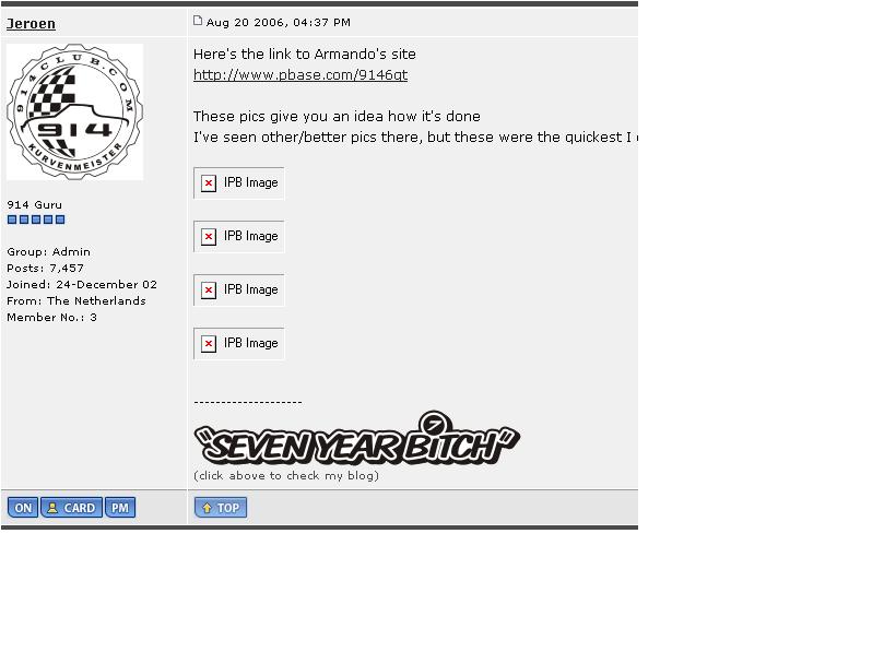

QUOTE(Eric_Shea @ Aug 21 2006, 12:44 AM) *
Yaaa-Roon... no pics (IMG:style_emoticons/default/confused24.gif)
whaddayamean? I can see the pics just fine (IMG:style_emoticons/default/confused24.gif)

This is what I see...

QUOTE(Eric_Shea @ Aug 21 2006, 01:23 AM) *
ok... that's weird...
do they work as links?
http://mishilo.image.pbase.com/u36/9146gt/...21.HBGT2006.jpg
http://mishami.image.pbase.com/u34/9146gt/...HB9146GT003.jpg
http://k53.pbase.com/u34/9146gt/large/2239...notherphoto.jpg

Good ideas, but these babies are nice. One is 33" the other 21." Guess the longer one is for the front.

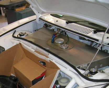

Funny how you get attached to nice hardware and will someway make it work, I should know. (IMG:style_emoticons/default/biggrin.gif)

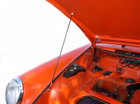

Another example, Chris Julian designed dual aluminum rods. You only see one up in this pic mounted ahead of the gas tank:
