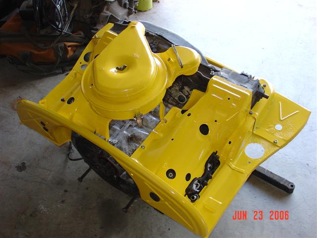

1972 1.7 stock D-Jet, I'm currently in process of a FULL rebuild so the door is wide open right now. Just about every system requires rebuild or replacement, typical 914 problems rusted battery tray, rockers, floor pan, tranny didn't go into 1st etc. etc. I'm just finishing the underbody and fixin to start preping for paint so it will be at least 6 months till I start with some high dollar purchaseing! The only thing I've done with the engine is cosmetic (powdercoated the tins). I have the original owners tag info. and it was purchased in Germany by a Capt. in the army who shipped it here! The odometer reads 64K no reason to believe the car has any less than 164K with the leaks it had before I tore it down. I only drove the car a week and didn't do a compression check. Just what I've read so far the original D-jet seems to be outdated and inefficent I'd rather have some new technolgy here!
