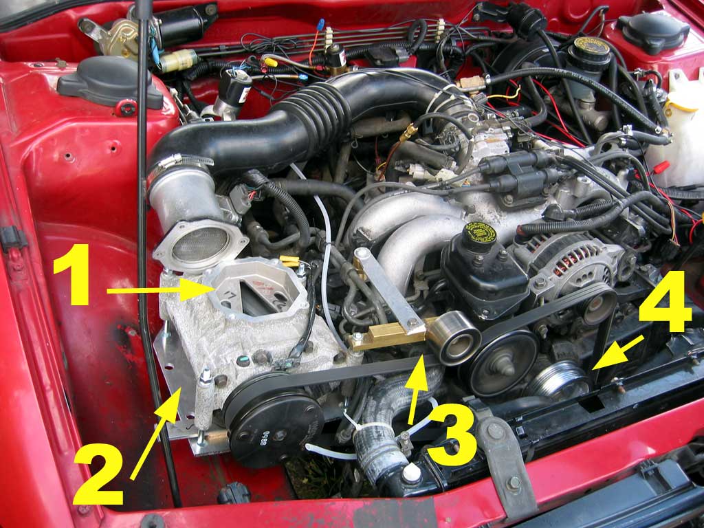

Been done a few times....even offered as a kit from some company in Colorado (Rippy or ripplen or RXXXX something (IMG:style_emoticons/default/smile.gif) )
There is also at least one supercharged Subaru over on NASIOC..
Supercharger install on Subaru,. homemade setup
the turbo has the advantage of being done thousands of times....you'll be on your own pretty much with the supercharger...
