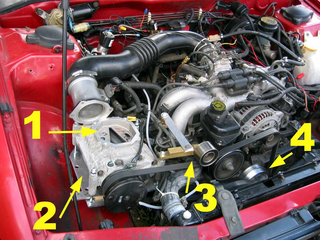

There is also at least one supercharged Subaru over on NASIOC..
Supercharger install on Subaru,. homemade setup
the turbo has the advantage of being done thousands of times....you'll be on your own pretty much with the supercharger...
