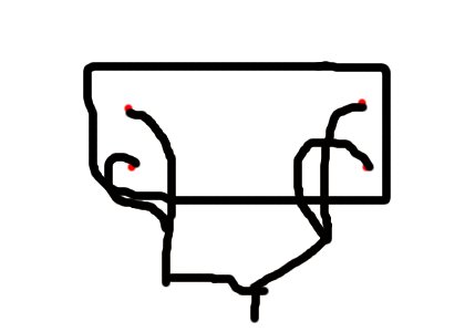

I know nothing about exhausts. Ive never had to mess with them.
I wanna HEAR my engine, so I'm building a exhaust.
I have a design that has backpressure, but no collector.
Is a system with matched length the best type of system, as shown in the figure?
And Is the use of a collector correctly used?
Hope its not too crude.

You are walking on ground that seems simple, but is the most scientific in the entire engine combo. It is always considered least by builders, when it is the second most important part of the combo!!
Without proper exhaust you have nothing, all the work and money that went into the intake and mechanical aspects can be totally wasted- what goes in must come back out, or at least about 80% of it! If this doesn't happen the engine will run rich, be untunable, run hot and not make any power. Exhaust selection should be made FIRST before chosing cam or heads!!
It looks like you plan a 4-2-1 system by the drawing, those are the most sdifficult to do because you have both primary and secondary lengths and diameters to worry about as well as collector lengths, tapers and goilets to consider. With a 4-1 system you have ONE collector, with a 4-2-1 system you have two collectors and collectors are an integral link in the chain!
if you do this right, as equally lengthed as possible you will quickly see why a Tangerine 4-2-1 arrangement is so expensive. If you goof up you won't know till you drive it and the engine runs uncontrollably rich.

Well....
To be honest with you.
Your basic design will work.
And you will be able to HEAR your engine as you show no muffler.
And unlees you get the primary's and secondary lenghts correct and use the appropriate collectors and muffler system.
You may well loose HP over a stock system.
I realize your drawing was rudimentary and doesn't show the real details of your thoughts.
So I suggest you make a better drawing to show us some detail. And that I will make comment on directly.
Note: My thinking is that the your 4 into 2 into 1 system is a good thought. Much like the newer Tangerine system.

The firing order of the T4 is 1-4-3-2. Your sketch shows primaries from 1 and 2 joined and 3 and 4 joined. To get a balanced flow you want balanced exhaust pulses, which means for a 4-2-1 system you should have primaries from 1 and 3 joined and 4 and 2 joined.
Check photos of the Tangerine systems or a Bursch extractor, all examples of 4-2-1 systems.

Good point, something I had overlooked.
