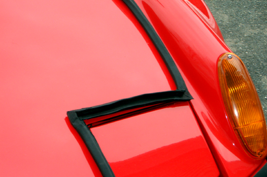

The first one looks OEM to me. The second aftermarket. The pics are a little blurry, but I'm pretty sure.
The OEM one has a thinner sealing flap, and lies almost parallel to the base of the channel into which it installs. The aftermarket one has a sealing ridge, as opposed to a flap, that actually looks nice IMHO, but probably doesn't compress enough to close the hood as tightly. Not sure on this, just speculating.
http://cgi.ebay.com/ebaymotors/Porsche-914...sspagenameZWDVW
Here's a pic of my aftermarket seal as I listed it on eBay a while back. I sold it when I decided to go OEM.
