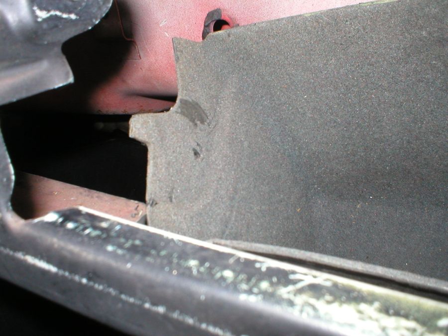

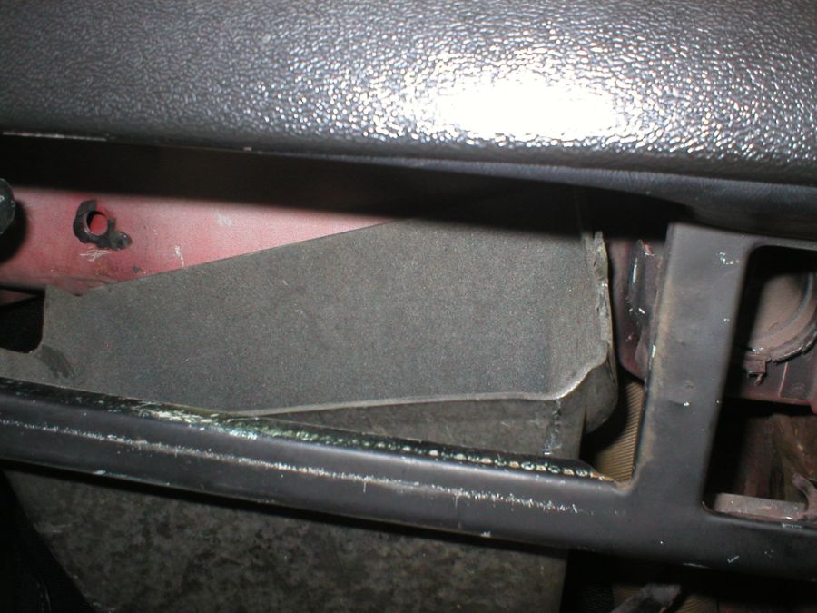

I was able to finally get the box into position.... Since I had so much problems with it yesterday, I decided to remove the door and dry fit the box. I found that the key to inserting it was to have the door aligned, the springs in place and the door CLOSED. I pushed the right corner in first, then carefully compressed the lower left corner. You'll notice a slight depression in the lower left corner of the box to allow it to clear the bottom section of the metal dash, underneath the radio.... After the box was in, as Andy mentioned, the box goes on the outside of the hinges/springs. Then I just stretched the strap until the hole fit over the driver's side bolt....
Thanks again and here's some pics that might help.... Door is removed for pictures only....
