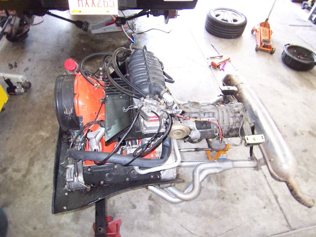

One hour flat. I think that's a new record for me removing a /6:
