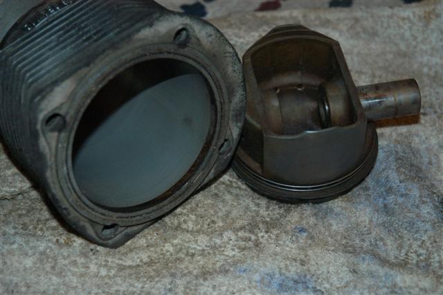

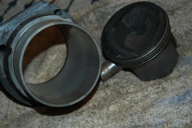

those are Deves rings , 3 piece oil ring ick, are those Kolbenschimt pistons or Mahle ? measure the ring thickness versus ring groove , chance off wrong rings installed.

clean that piston with acetone or carb cleaner.. the story will become much clearer...
I was just by a Buggy Shop yesterday, and they have all their "best hits" sitting under glass. A screw was sucked into a barrel and made the most PERFECT impressions (multiple times) all over the combustion chambers and piston before they broke. The detail was so perfect, it looks like you are actually looking at the screw itself! You have to study closely to see it's a concave/negative impression.

They're Mahle piston/cylinders.
Because it failed the way it did, I'm going with good old fashioned piston failure.
Broken rings are one thing, but this was almost catastrophic. Again, I'm going with a simple piston failure.

QUOTE(Aaron Cox @ Sep 28 2006, 04:18 PM) *
QUOTE(GTeener @ Sep 28 2006, 04:15 PM) *
Ouch. How do the piston rings break?
look closer.. how do RING LANDS break?
Yep.
Piston, not rings is the root cause based on the picture...
How's everything else look so far Joe?

QUOTE(Matt Romanowski @ Sep 28 2006, 09:11 AM) *
Shoot, we've run turbo motors with no rings. High RPM race motors only run 1 ring - thin too - about 1mm.
Matt
small hijack - Matt, you have ran no rings whatsoever? I haven't heard of that before... but agree on the single compression ring thing. Built a 347 Ford for a guy years back that had 30+psi boost, ran a thin oil-control ring and a single 1/16" compression ring to get the crown above the top ring land as thick as possible. They only have a 1.090" compression height to begin with so 3 rings were just too tight and would hammer the top ring land down if he went a little lean..
which brings me to this question for Joe...
Do you see signs of detonation on the top of that piston? Does it look like the top ring land hammered down onto the ring? Detonation can cause that, and once that top ring gets squished, then what you have in your had is what I have seen - just blows all the ring lands to pieces. Won't have a melted piston, just hammered upper...
Your plug is all cruddy, but do the other plugs show detonation? I would worry that there has been long term detonation hammering the crowns on all the other pistons too and that was just the first to let go... proceed with caution. I have really never seen a piston fail "just because" or bad machining/casting tho' truly possible. Just more likely that piston failure was "caused", not "the cause".

Were the injectors checked out? Fuel distributor? I'm thinking lean detonation/heat issue. I'd say check the injectors, if you haven't already.

QUOTE(McMark @ Sep 28 2006, 07:44 PM) *
Every injector was flowed before we started the car the first time.
It's a new fuel distributor and it's a little rich right now.
All the other plugs look slightly on the rich side of normal.

Top ring clearence checks at .003"
The second ring is completely missing.

Member No.: 2,744
Its the second ring where there can be a problem. 1.5mm or 1.75mm
2 different ring set P/N's
Check a good one to be sure or for shit and giggles.
