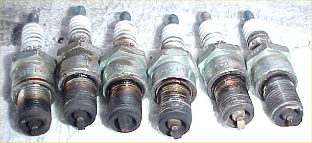

Here's my NGK B8ES's.
The three darker ones are from the passenger side.
KT

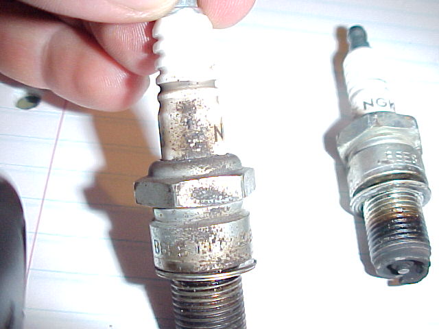

also, now that I run those dual glass packs, i can see that the passenger side puffs more visible light blue/grey smoke when idleing. ( side with darker plugs )
two plugs have a strange pitting. Almost arcing scoring or checking on the insulator and hex head.
second from the left and the one in this pic.
KT

QUOTE(trekkor @ Nov 7 2006, 08:35 PM) *
KT
Aside from the second plug from the right,in your picture,they seem to be running too cold.....B8ES is two heat ranges too cold for your car B6ES is the recommended plug for a 914.
