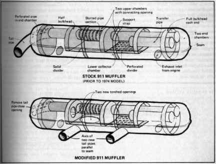

Here's how they're modified:

Mark Henry
post Nov 6 2003, 09:25 PM
that's what I do!
Posts: 20,065
Joined: 27-December 02
From: Port Hope, Ontario
Member No.: 26
Dave's (Lotus914) banana is done that way. I drove his teen, sounds cool.
I'm a bug guy and I never thought it looked or sounded bug.
