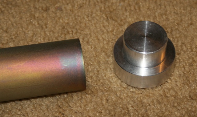

I have a set going up to Canada pretty soon (waiting on a backlog of axles from my supplier (IMG:style_emoticons/default/headbang.gif) )

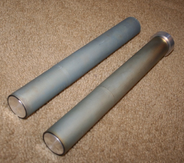

When I finally get around to shipping them (before he cancels the order which wouldn't surprise me) I'll be including these simple yet nifty install helpers..
The pieces installed on the inside of the tubes are to help prevent the tube from getting out of round while being pressed into the trailing arm. Once fully installed, the pieces can be knocked out from the other side.
The other piece is to have a flat surface for pressing or for (IMG:style_emoticons/default/smash.gif) ...I know, the hammer method seems crude, but it works and is fine for this application....and when I mention hammer, I'm not talking some wimpy claw hammer or ball-peen hammer, you need a manly 3 or 4 pound sledge hammer....
If you have a kit that you bought from me or from Tarett Engineering, these pieces are free, if you bought a kit from eBay or Shine Racing, kiss my @#$...just kidding (IMG:style_emoticons/default/biggrin.gif) , $20 will get you these parts....
