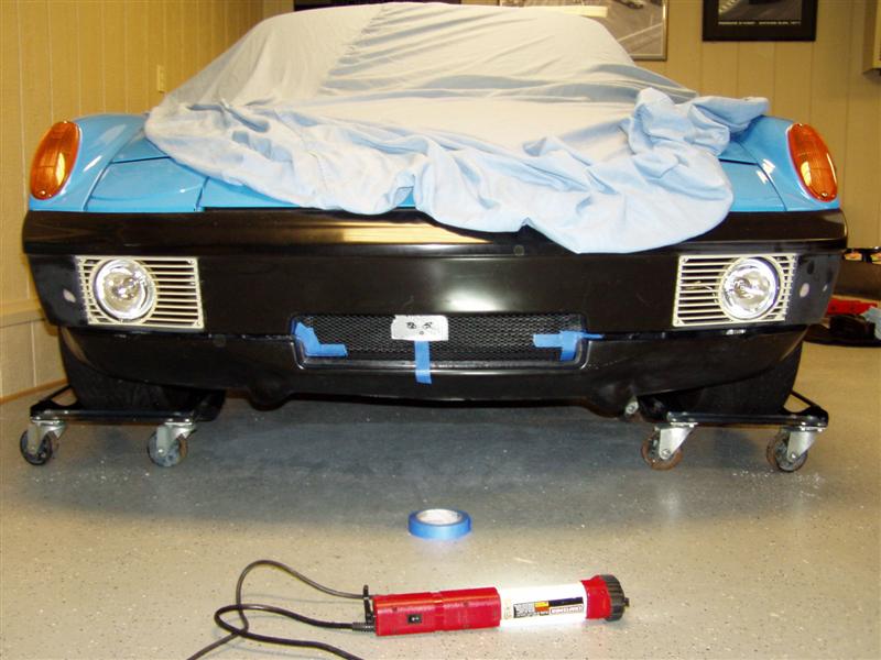

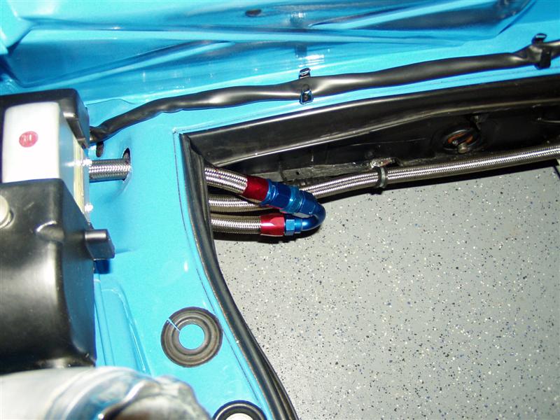

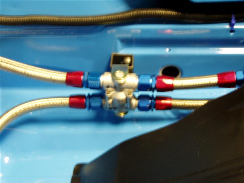

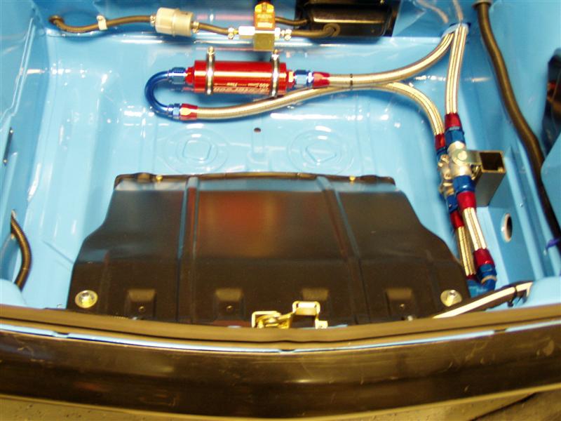

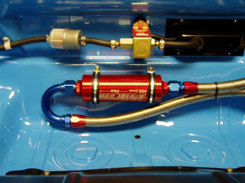

I had inquired a few weeks ago about the best source for fiberglass Gt bumpers and valances. I ended up going with Getty. Someone on the board had asked to reply on the fit. The front bumper did not need to much adjustment, slight sanding of the edges to fit. The valance had to be heathed with a propane torch and slightly bent but It ended up fitting well. I would definetly use Getty again. Attached are the mock up pics of the bumper and valance. Also attached are the pics of the oil cooler system that started the whole process.

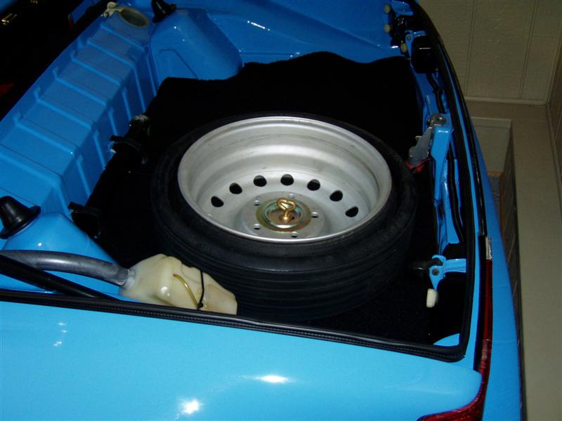

Do you have a pic of the rear trunk with the spare out?

Did the Getty bumpers come with the mounts attached, or did you have to glass them in?

Thanks again. Qarl, I had to glass them In and fiddle with them in order to get them to fit correctly. That was the hardest part.

QUOTE(Racing916 @ Oct 24 2006, 05:14 PM) *
replace that faucett fuel pump with a rotary pump! you'll thank me later ... (IMG:style_emoticons/default/cool_shades.gif)

I also just recently put on Getty bumpers (less than 2 months ago). I had basically the same experience. Glassing on the mounts was the most time consuming part, and I had to do some minor fitment adjustments. I still have to file down some trim where the fog light grilles go, but I'm very pleased so far.
Definitely worth their price.

QUOTE(SirAndy @ Oct 25 2006, 09:28 AM) *
otherwise, very nice and waaaay to clean!
(IMG:style_emoticons/default/smilie_pokal.gif) Andy
I hate to ask the obvious but... WHY?
