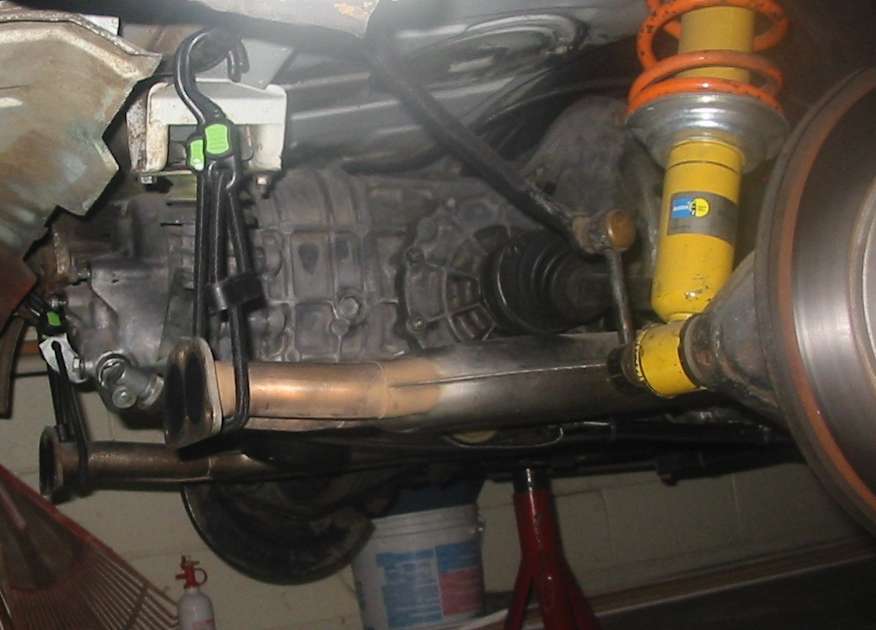

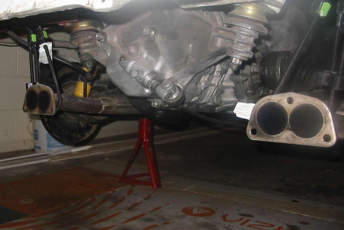

I gotta lot going on with the car. When it returned from my son's homecoming, it was backfiring back through the carbs (mildly, and different barrels, about 1 or 2 minutes between "poops"), so I'm doing some compression evaluations. Also got the carbs off to rebuild, since I originally thought I had a blocked passsage. Gonna mess with the jetting a little too I think. And this is a good time to replace my fuel lines, which I thought had already been done, and maybe even weld up some suspension cancer I know is in there. But the instigator of this is really DR. EVIL (cue scary music). Over the next few days I believe the gear stack is gonna come on down. Get ready Doc, 'cause it'll be scary. She's been hacking along for several years now, and it has gotten even worse. Here are pics as we prep for surgury...

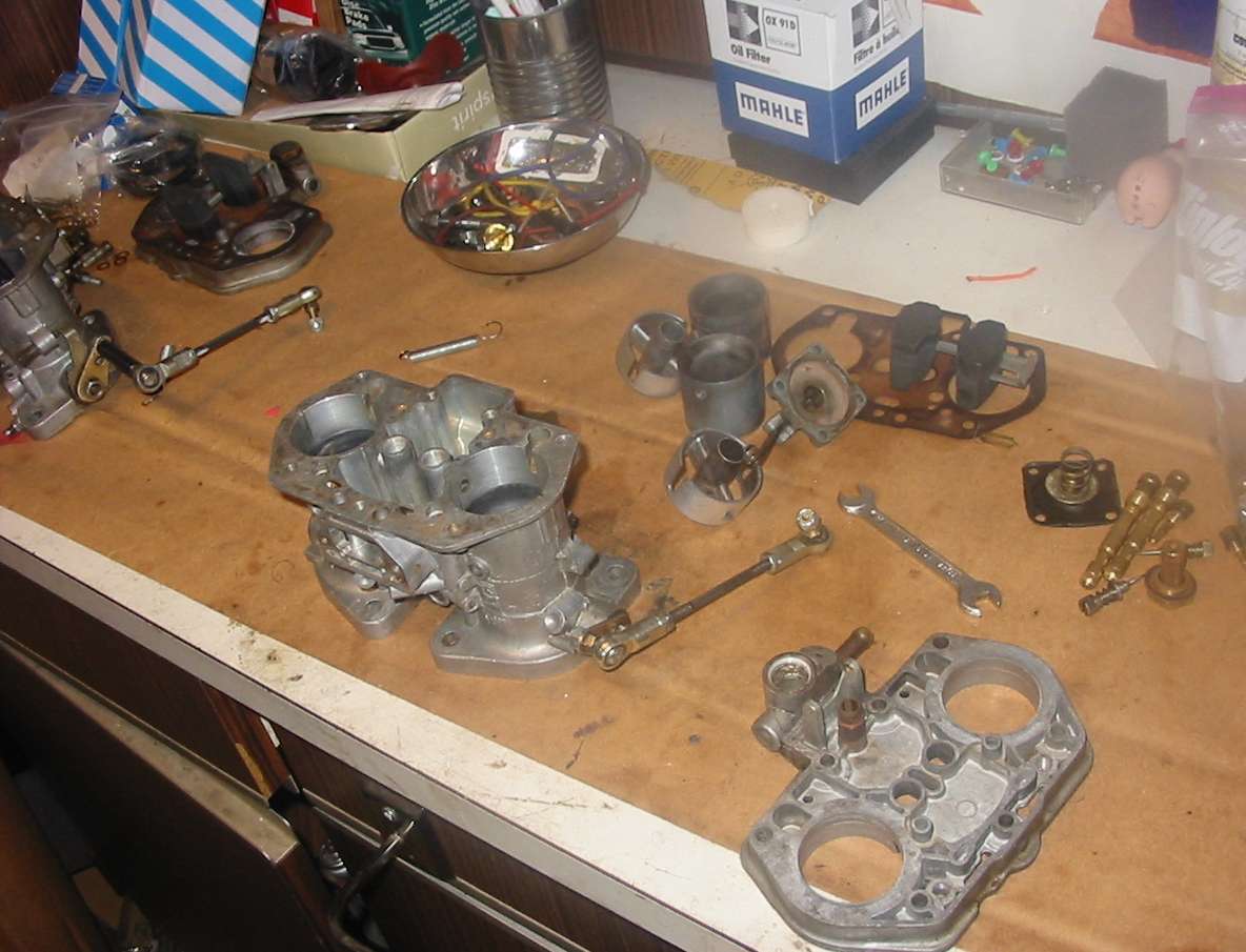

carbs...

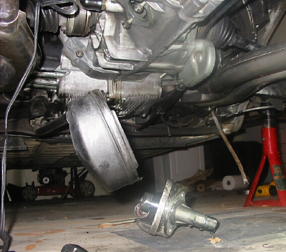

Well there have been several delays and sidetracks, but I'm back on the gear stack removal job (at least intermittantly). I really wanna get this thing of to the Doc fer a rebuild soon-
No later than 1 December is my goal. So tonight I just did a little more clean up, disconnected the shift lever, drained the fluid, and dropped the shift console. I guess the rear cover comes off soon...

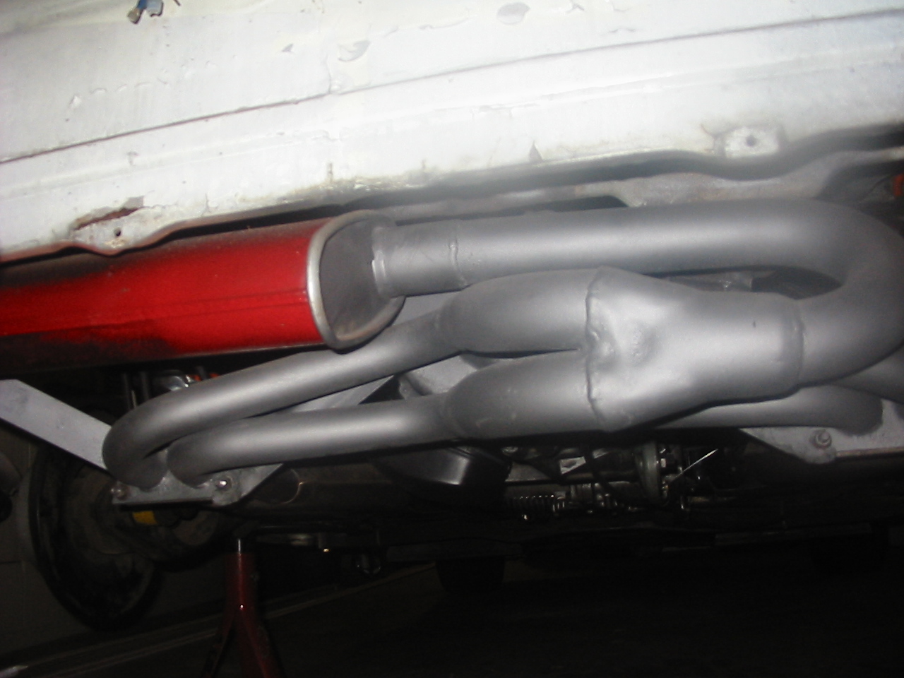

That Bursch exhaust looks pretty clean. Is that paint, jet-hot coating, ceramic coating or...? Has the finish been on for long?

It's just high temp paint-
that coat is pretty fresh (2 or 3 months since a touch up sparay)
I painted it before I ever put it on and most of it stays pretty adhered. I've sprayed it three times in about 5 or 6 years.

Separation complete.
But thereis still a buncha stuff on the front of the trans that were supposed to come off to get the intermediate plate off. Iwould prefer to leave all that front end stuff attached- like the speedo gear and all behind it are still in place_

I am not following you on this description. You should not have to remove anything from the "front" to get the stack off. The intermediate plate comes with the gear stack (see pic). The speedo drive does stay on. All you need to do with what you ahve is to remove the rear cover, remove the 1st reverse gear and associated bearings all of which just come off. The rest you send to me.

I gotcha doc- for some reason I thought the speedo drive had to come off. The tail cover tapped right off, and opening it on the bench meant the reverse gear didn't fall out, just the washer and little flat needle bearing. I'll be boxing the rest up to take to fed ex Saturday.
