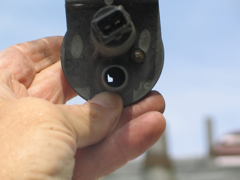

The big question is whether the AAR works. Take it out of a cool engine and look through the hole. If it looks about 1/3 to 1/4 open, then hook up a + and - wire from your battery to the AAR's terminals. The hole should get closed off within 5 minutes. If it does't close, try the PB blast.
I timed mine at 1min 55sec to close. If it passes this test, you could have a vacuum leak from a hose. I recently added a vacuum gauge to one of the lines going to the plenum. If idle get's errratic due to a vacuum leak, the gauge will drop in pressure.
