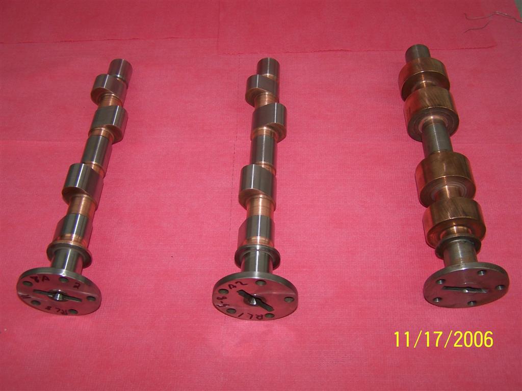

After 5 months of busting ass the final prototypes are completed...

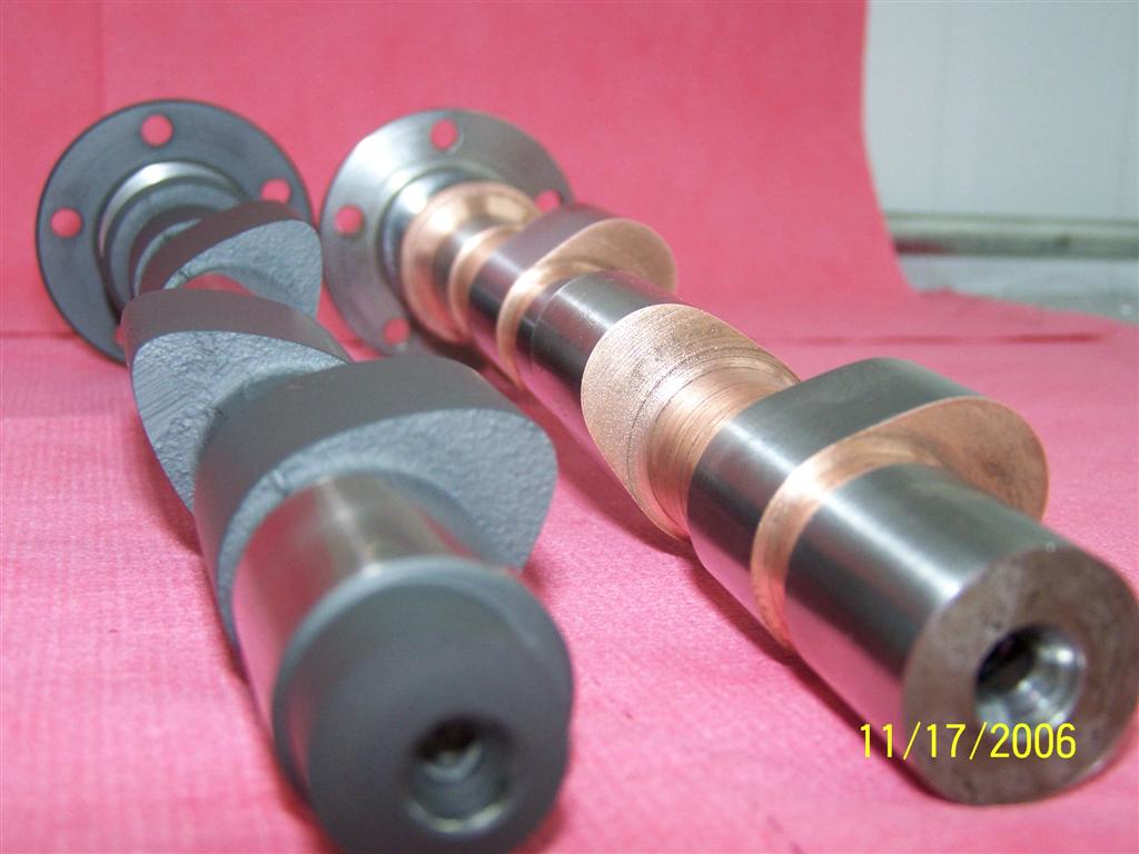

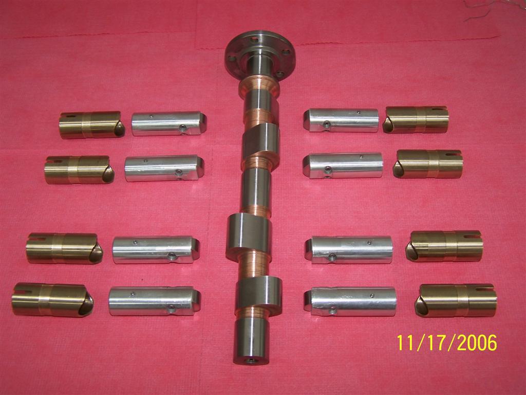

In the pics attached you'll see the roller cams and lifters that will help to boost the TIV even higher in 2007 and beyond...
In one of them you'll see a roller cam thats only 2 degrees altered from it's flat tappet cousin side by side for comparison- they'll be getting tested the same way- back to back.... The roller cam is also only .010 healthier on lift than the flat tappet, but look at how much of a difference the lobes have....

I can't wait to hear more. (IMG:style_emoticons/default/thumb3d.gif)

Those be some crazy lobes! (IMG:style_emoticons/default/happy11.gif)

Honkin big!!
I look for 20% more torque from these bad boyz!!!
As well as 2056 engines as strong as last years 2270s!

why the copper plating?

jake, those are SOME CRAZY ramps!!!very cool!!!!
so they have a 'bushing' that keeps em straight.. keyway style. nice!!!

The copper plating keeps the heat treat from penetrating into the shank of the cam, making it brittle and easy to snap..
