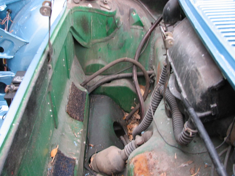

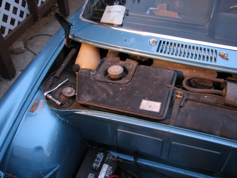

Hey guys, here's some shots of how I repainted/restored my gas tank and that whole area.
This is what I started with...
thomasotten
post May 22 2007, 11:53 PM
Post #107
Posts: 1,589
Joined: 16-November 03
From: San Antonio, Texas
Member No.: 1,349
There's that green paint again...still can't figure out why the factory would choose to paint all the insides of a car green that was meant to be blue. (IMG:style_emoticons/default/screwy.gif) (IMG:style_emoticons/default/blue914.jpg)

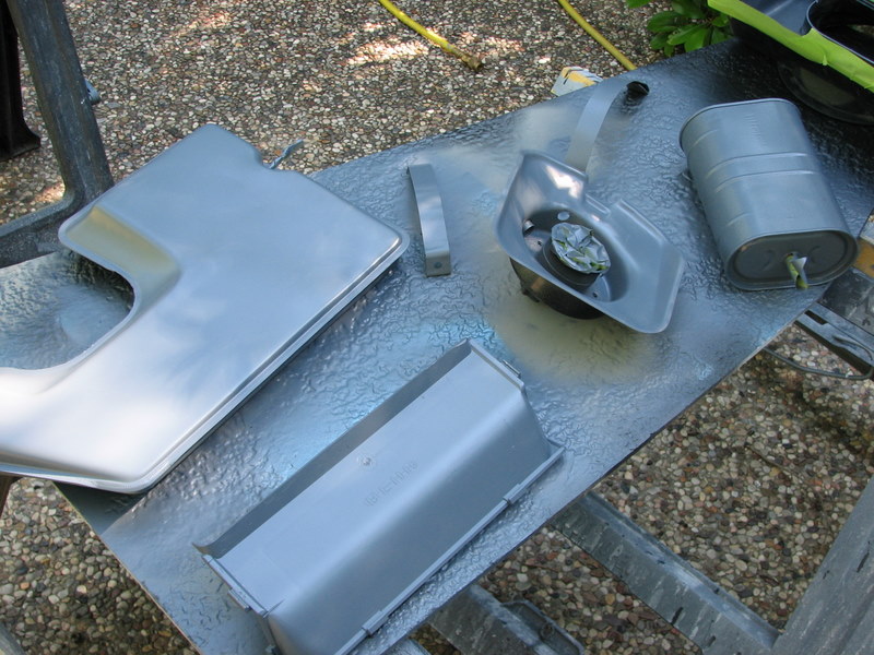

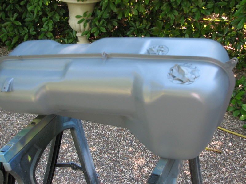

Pulled the tank, cleaned it real well, braised up some holes, and then shot it with sealer...

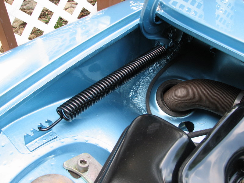

Don't forget the springs...

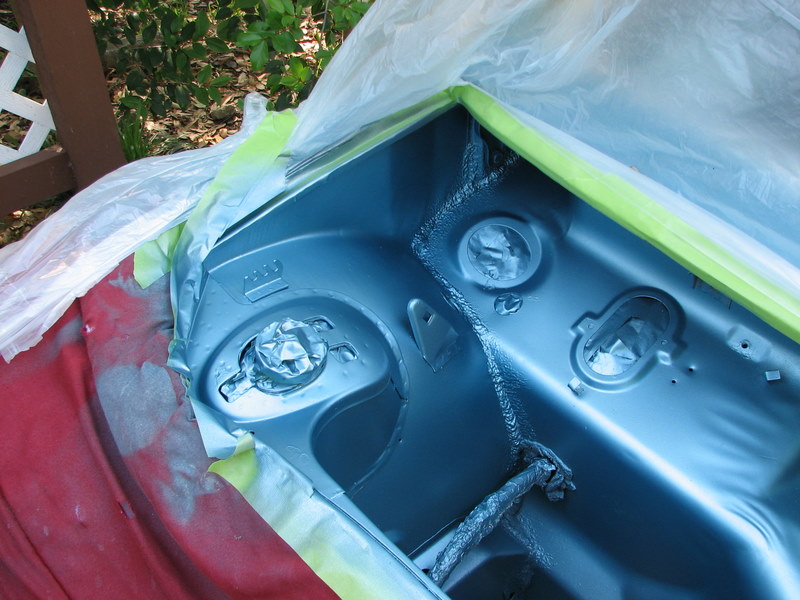

Sealed this area, after a thurough cleaning...

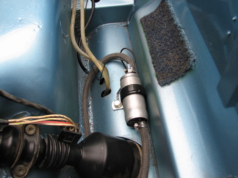

Installed a new fuel pump while I was there. My old one was in the trunk. This one's a rotary and nicely hidden.

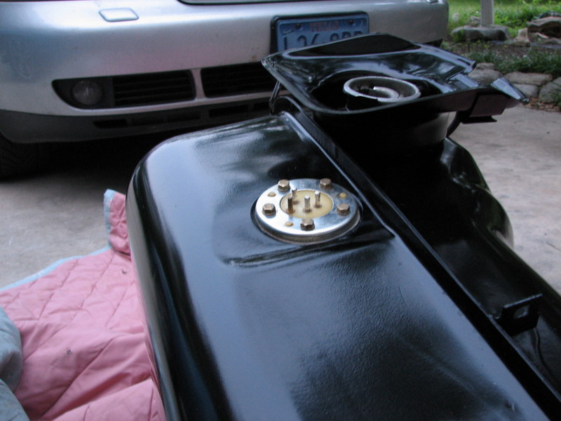

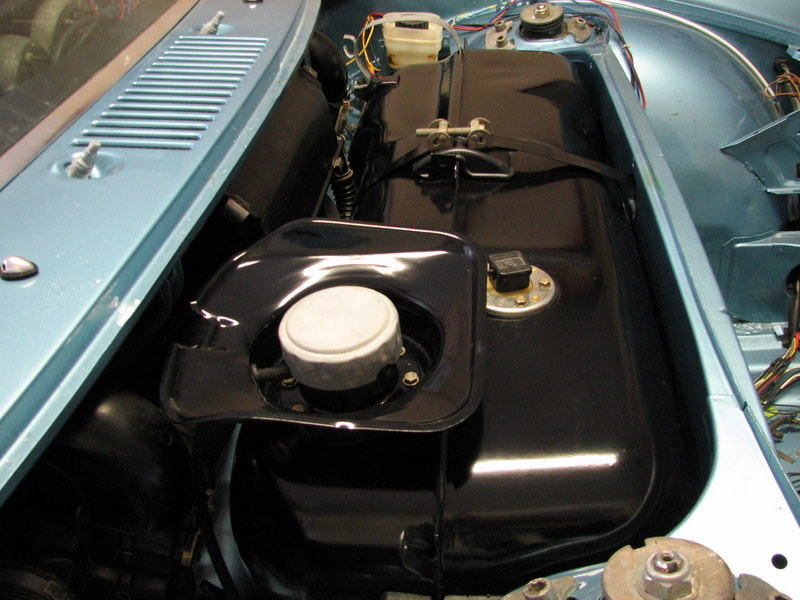

Here's a shot of the tank. To paint the tank, I used a black base coat, followed by Hot Hues Matte Clear. I didn't want it too shiny...

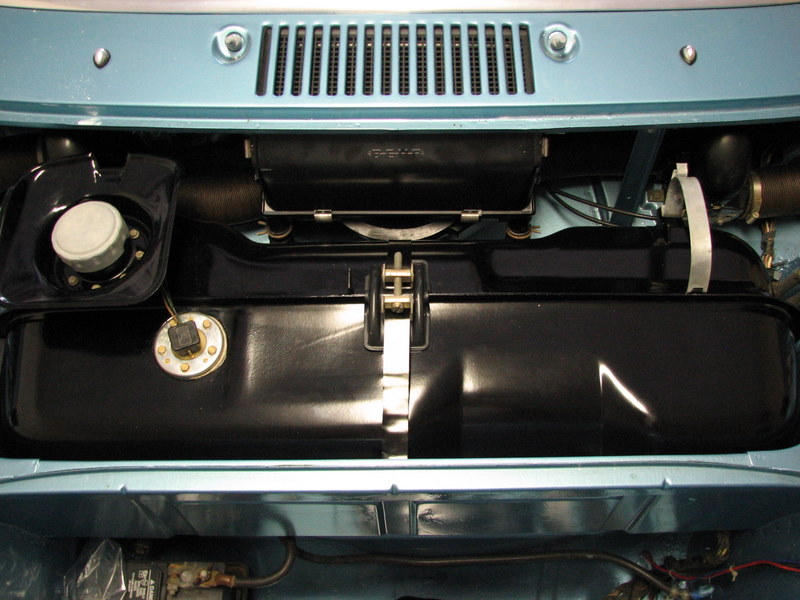

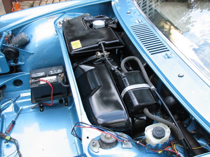

And back in she went...

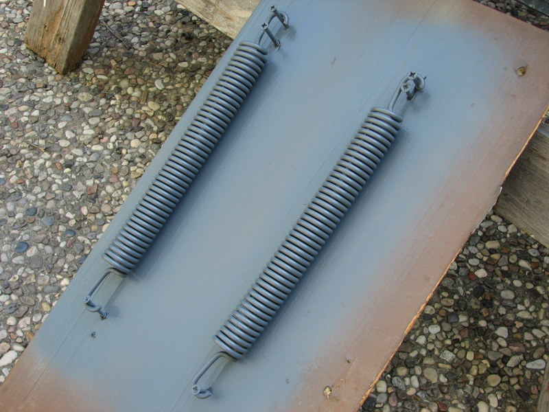

Springs came out nicely...

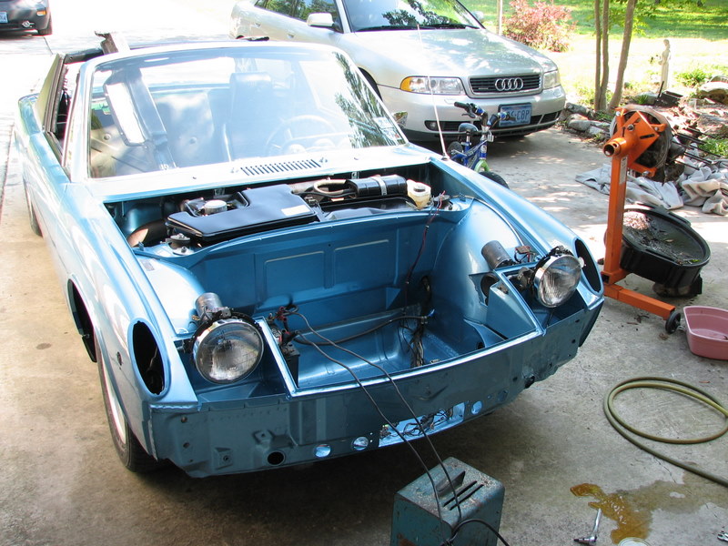

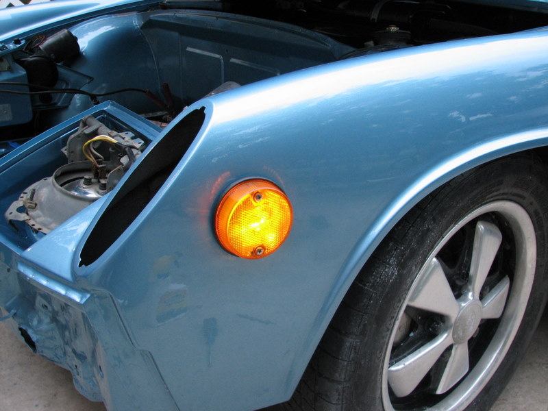

Got some brand spanking new lights...
