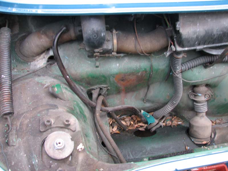

QUOTE(Bartlett 914 @ May 1 2007, 06:18 AM) *
I hope to paint my project this Spring. This thread has been a real inspiration. I have a question about the trunks. I assume you used the same paint with a base coat and a clear coat without sand the clear. I would think that would really be a pain.
The trunks are easy, and they are great for practice! But yes, you won't need to buff that, and you will want to be careful not to get runs. But even if you do, no big deal, you can take care of them by hand. They will have more grease issues, so you will want to degrease them with something like simple Green BEFORE you sand anything. Once you start sanding, there is the potential to imbed grease into the paint. Cleaning these areas can be a real pain, but it is worth it. The beauty is in the details.
Take your time and you can turn this....

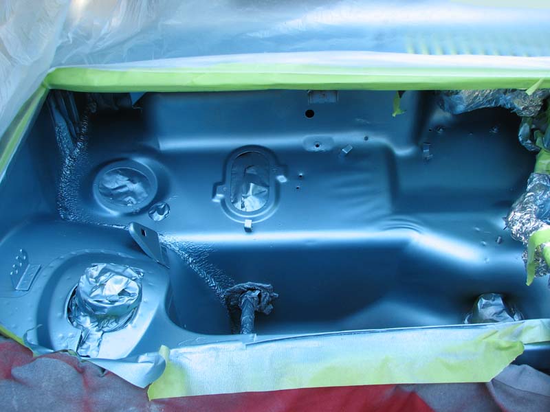

thomasotten
post May 1 2007, 09:55 AM
Post #99
Posts: 1,589
Joined: 16-November 03
From: San Antonio, Texas
Member No.: 1,349
into this...
