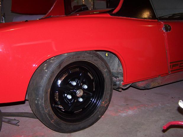

Here's rattle can quality painting. Gloss black.
Wet sand 220, then 400. Prime, then wet sand 600 and paint.

Spoke,
That looks pretty good. What paint did you use?
