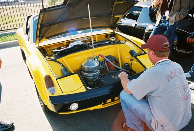

Series9
post Dec 7 2006, 11:36 AM
Lesbians taste like chicken.
Posts: 5,459
Joined: 22-August 04
From: DeLand, FL
Member No.: 2,602
Mine:
