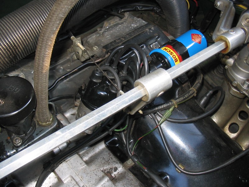

I've been running Dells on my car for around 20 years--and I'm here in VA (near Williamsburg). I have some articles on how to set up the carbs--IIRC, they were pretty useful at the time. I could make copies and send them if you're interested. I think I also have some specs on what venturis, jets, and e-tubes came on which carbs--it may give you a good place to work from.
I also added a picture of the throttle cable set-up on my car. I'm using the CB hex-bar linkage and manifolds that came with the kit. No clearance issues, even with the rain tray in place.
Is Centreville VA near Dulles airport? I need to make a run up there on PM 20 DEC . . . but I won't be in the 914.

I seem to have hit a couple of snags while installing my new dells this weekend:
My linkage bar appears to be too long, and they don't make one short enought (the one I have is 19", and I need one 16":

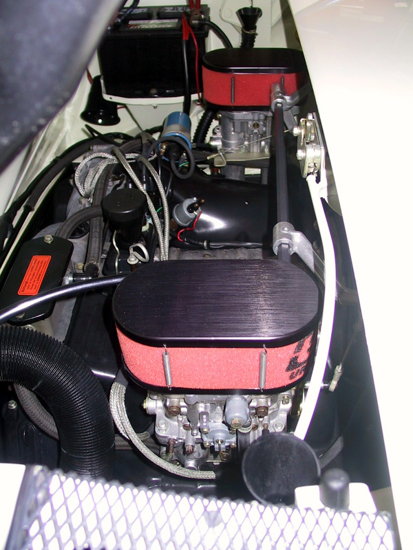

Here is a pic of my setup - I have been running dells for 18 years on this car -have have no problems with the CB linkage.
facing the arms toward the rear simplifies the cable hook up.
My carb linkage brackets had two mounting holes on the carb plates for the cross linkage -one high up and one lower which I used. Doing this clears the rain tray. I trimmed off the portion of the post not used.
The cross bar is longer than needed- you have to trim it.
I made a simple cable bracket that mounts to right side carb- no problems with side loading of the linkage or sync of the carbs.

QUOTE(Kargeek @ Dec 30 2006, 03:14 PM) *
That's a really nice looking setup, I'm going to redo mine tomorrow and face the arms backwards also.
How did you cut the crossbar? I'm thinking I'll have to get someong else to do it. I have a grinder, but I'm not sure how the finished product would be if I tried to use that. I'd also have to drill a new hole in the center of the cross bar for the spring and ball to go into.
Do you guys have any input on the other issue I have - mating the linkage from my cb kit to my dells? I'm wondering if I can replace the plate mounted on my dells to make it work
Kargeek
post Dec 31 2006, 02:03 AM
Post #40
Posts: 555
Joined: 14-March 03
From: Orange, CA
Member No.: 430
Terry,
I believe the crossbar is rifle drilled- that is, there will be a hole remaining after you cut it to length. Or, check to see how deep the hole is drilled on each side and cut both ends to fit. The bar is made longer than needed to fit different applications.
Cut it straight with a hack saw and file it to final size. Better to cut it long and keep trimming it to size.
DH
