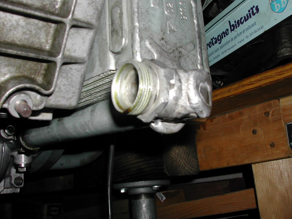

brp914
post Dec 28 2006, 09:54 PM
Post #28
Unregistered
one way is like so...

ClayPerrine
post Dec 29 2006, 06:32 AM
Post #31
Posts: 16,488
Joined: 11-September 03
From: Hurst, TX.
Member No.: 1,143
QUOTE(Jeffs9146 @ Dec 28 2006, 10:52 PM) *
Can I use the 2.0L oil cooler and avoid the cutting and welding?
Jeff
No.. the 2.0L 911 cooler comes straight out the end, and will hit the trailing arm.
You need to alter it, and it is smaller than the 3.0 cooler that is on your engine.

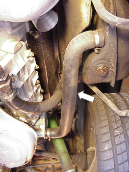

echocanyons
post Dec 29 2006, 01:53 PM
Post #36
Posts: 2,109
Joined: 24-December 02
From: Bay Area, CA
Member No.: 7
here is a picture of the 911 setup, you can see the hose and clamps on both ends.
(picture from pelican parts )

echocanyons
post Dec 29 2006, 01:54 PM
Post #37
Posts: 2,109
From: Bay Area, CA
Member No.: 7
(IMG:http://www.pelicanparts.com/cgi-bin/smart/imgdsply.cgi?url=../../images/oil_circ/S-hose.JPG)here is a stock 911 picture with te clamps at both ends.
