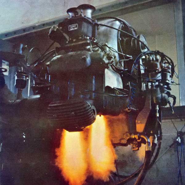

its easy, just stand back till she clears the tower... (IMG:style_emoticons/default/boldblue.gif)
actually i just love this picture.

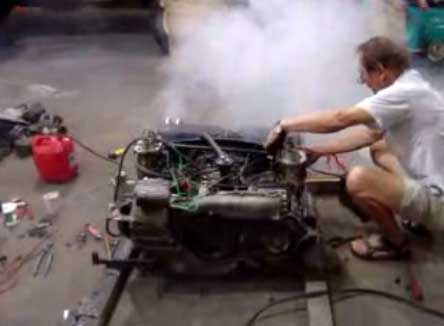

OK, this is probably not the best way to do it but it looks like fun..
http://www.youtube.com/watch?v=sjitKUvzyIw
I just found this, don't know who it is but i'll bet he's a member.

Funny stuff. That was Leo Imperial's engine in the video. We got it going late one night in August @ Movietime in Lyndhurst, NJ - was a lot of fun.
Leo offered the engine to me that night when we discovered my top end rebuild was to need new pistons and a new head... I was an idiot & decided to forge ahead w/the rebuild. Rebuild still in progres (rebuild, v4.0 that is....).
BTW, that engine had been sitting unused for 20yrs and fired right up once we got all the electrical connections good and tight. MAKE SURE YOUR CONNECTIONS ARE CLEAN AND TIGHT - it made all the difference when trying to turn her over...
