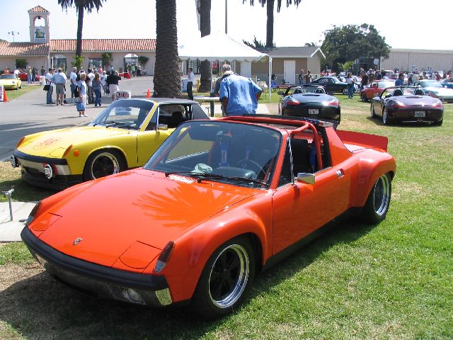

Dekman has the wide flares in the rear...
I know he has more pics floating around if you search for them...

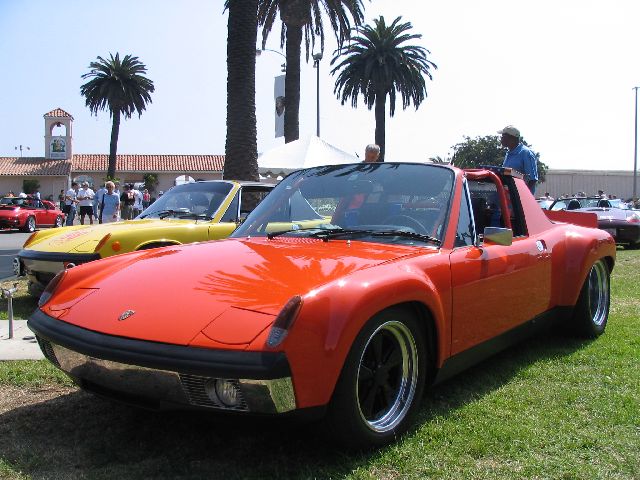

I'm pretty sure I got a couple of pics of the same car at GAF 2006.

dekmans are custom widened metal rears... nice work.
7's and 11' flares

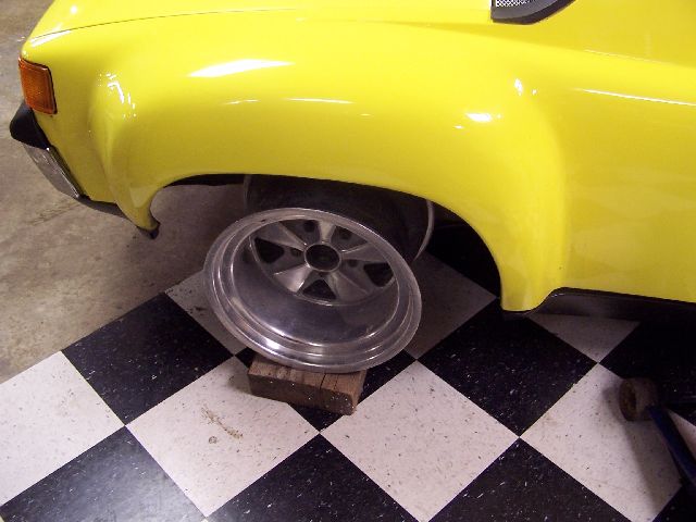

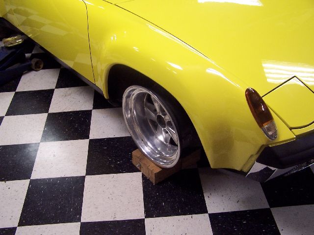

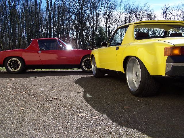

A few more pics of 9" and 11" steel GT flares on JLO.

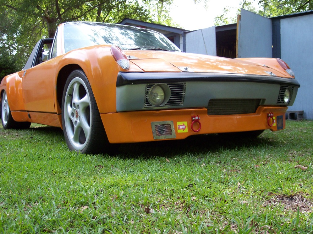

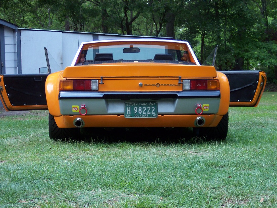

I like'm that way.Next order of bidness will be to replace the glass flares with steel ones.
Ya gotta love the wide look. (IMG:style_emoticons/default/biggrin.gif)

Craig and Ron...Those cars look killer with those flares. I wanted the 11" when I did mine but could not find them at the time. I am presently considering a change to "steel" so I may change the 9" to 11" if I can find someone who can make them. (IMG:style_emoticons/default/driving.gif)

The do-it-yourself method is the only thing that's gonna work in this case.
I'll be widening my own rears when the time comes.
That's what they make mig welders and grinders for. (IMG:style_emoticons/default/welder.gif) (IMG:style_emoticons/default/sawzall-smiley.gif)
